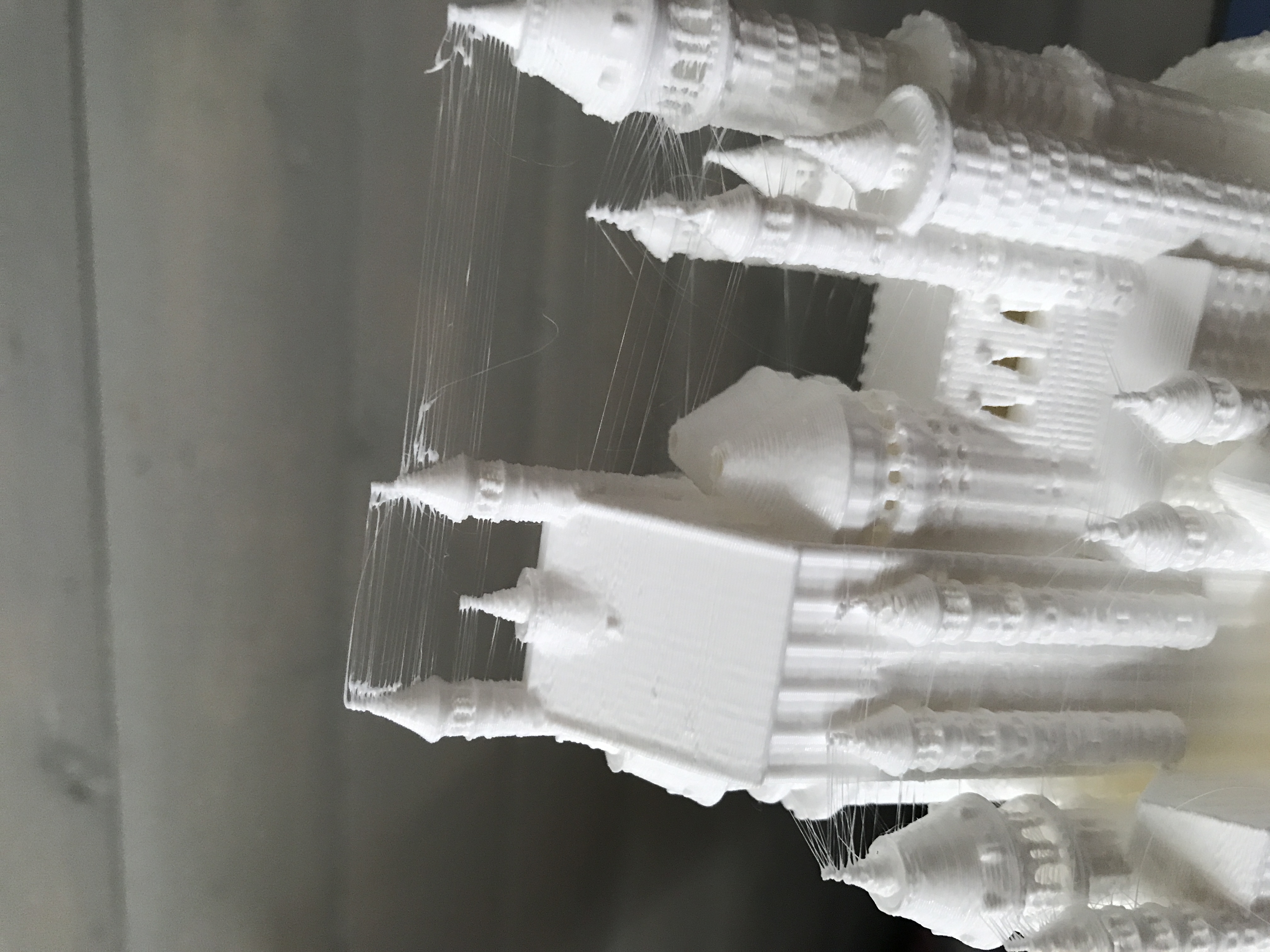

Hey guys! So I've been messing around with different profiles for the Flashforge Finder for quite a while, including the original profile, but I always manage to get really stringy prints, and it is very annoying because it even strings in small locations where I can't remove the strings.
I would like to get almost a "string-free" print, would be so much nicer. I mean, a 3d printer should be able to print without stringing all the time right?...
So here is my profile I'm currently using, and I'm using white HT-PLA running on the companys recommended degrees. As I said, it's the Flashforge Finder printer.

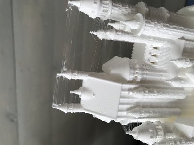

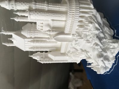

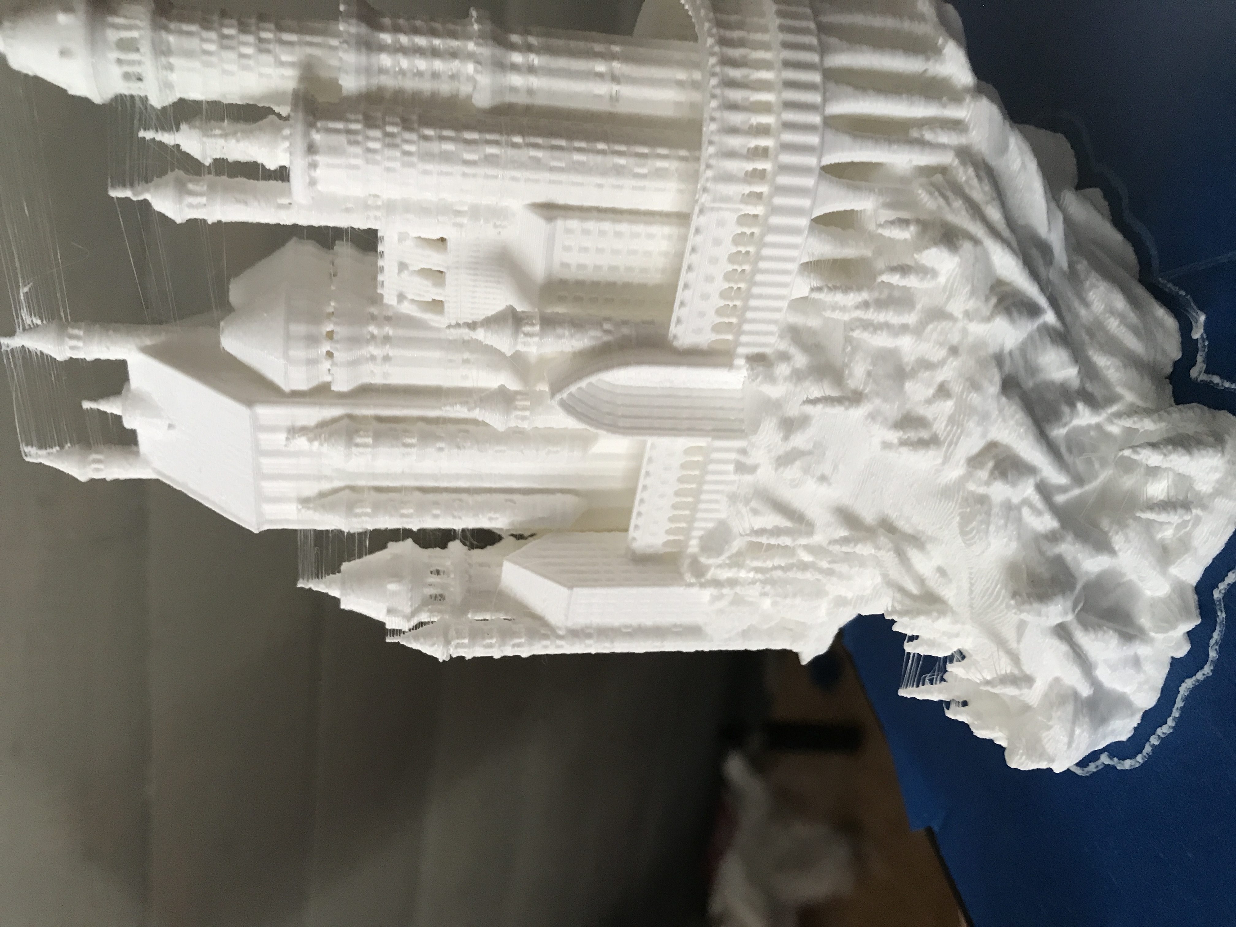

Sorry guys I was supposed to post pics but I forgot to upload 'em, here you go.

Eww. Are you overextruding a bit? Your brim also look kind of strange (very blobby).
And that was printed with the profile I gave you? (btw. you can set the "extrusion width" to "auto" again. S3D V4 seems to handle that better now. I forgot to switch it back before I gave you the profile)

Yeah I'm using your profile @darKing .. so does overextruding cause stringing aswell? How can I fix this then? I have tried the default Flashforge Finder profile but it looks really bad tbh... I thought this software was going to be simple to use like just pick the default profile and get good prints..

Well... I did get decent prints with the default, and then I tweaked a little bit. But the default PLA profile worked pretty good for me. However, every Material is a little bit different.
Did you also print one of those test-prints I gave you? (the links to thingyverse). Your profile certainly indicates that. Can you make a photo of those?
