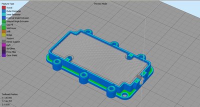

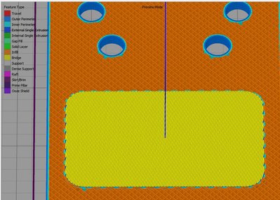

I am printing some boxes that they have to print face down and therefore need supports.
The strange is that s3d even though that calculates correct the supports on top of them is putting also a bridge (attached images).
Isn't that a little crazy? What is the point of the supports then?

georgei wrote:Isn't that a little crazy? What is the point of the supports then?
not crazy, proper way to do things, this way support supports your bridge from sagging and you have easy to remove support

Although it's only for very short distances, there are gaps between the support material ribs that it technically still has to bridge over. You should be able to back off on any tweaks required for true bridging, which might speed up your print slightly, but it's still printing over thin air for a good portion of the supported region. It's just broken up into short enough gaps that the filament doesn't have a chance to droop or otherwise mess up. It may still be a good idea to play with a little over extrusion to make sure the filament bonds to adjacent passes, because there is nothing for the bottom layer to squish against in the gaps.

It will make sense if the supports where not dense.
But the last two layers of supports are 90% infill.
The bridge layer just make a total mess of the surface because it follows of course the bridge settings (which are not for printing over a solid layer).

I honestly would not think about it any further.
Although those layers in the preview are indicated as being a bridge, it willmake no difference at all for the overall result.
Laying on supports they never ever will come out exactly as smooth as solid layers on the bed.

If you don't want any bridging to take effect, simply set the Unsupported Area threshold to 99999.0 sq mm.

georgei wrote:It will make sense if the supports where not dense.
No, there should be 1 separation layer between the top of the support and the first bridge layer. The bridge settings are just a slight modification to the extrusion profile.
In your preview verify the bridge layer is running at a non parallel angle to the last dense support layer. 45 to 90 degree difference is preferred.
