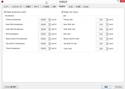

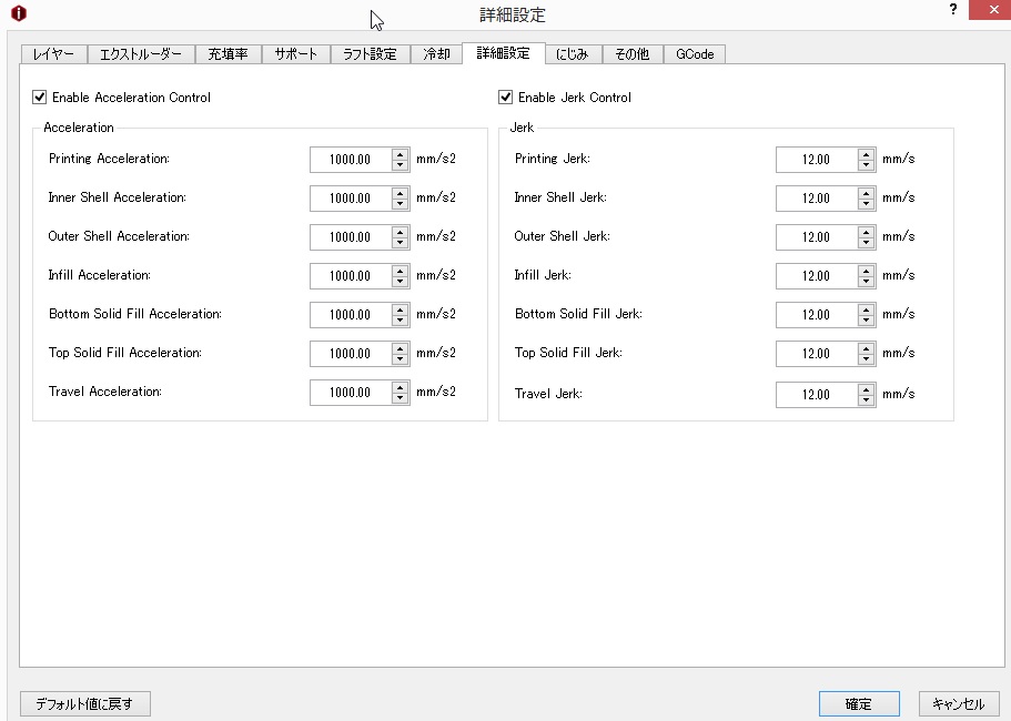

I want to set not only speed but also acceleration and Jerk.
The following is the setting screen added recently in IdeaMaker.
