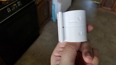

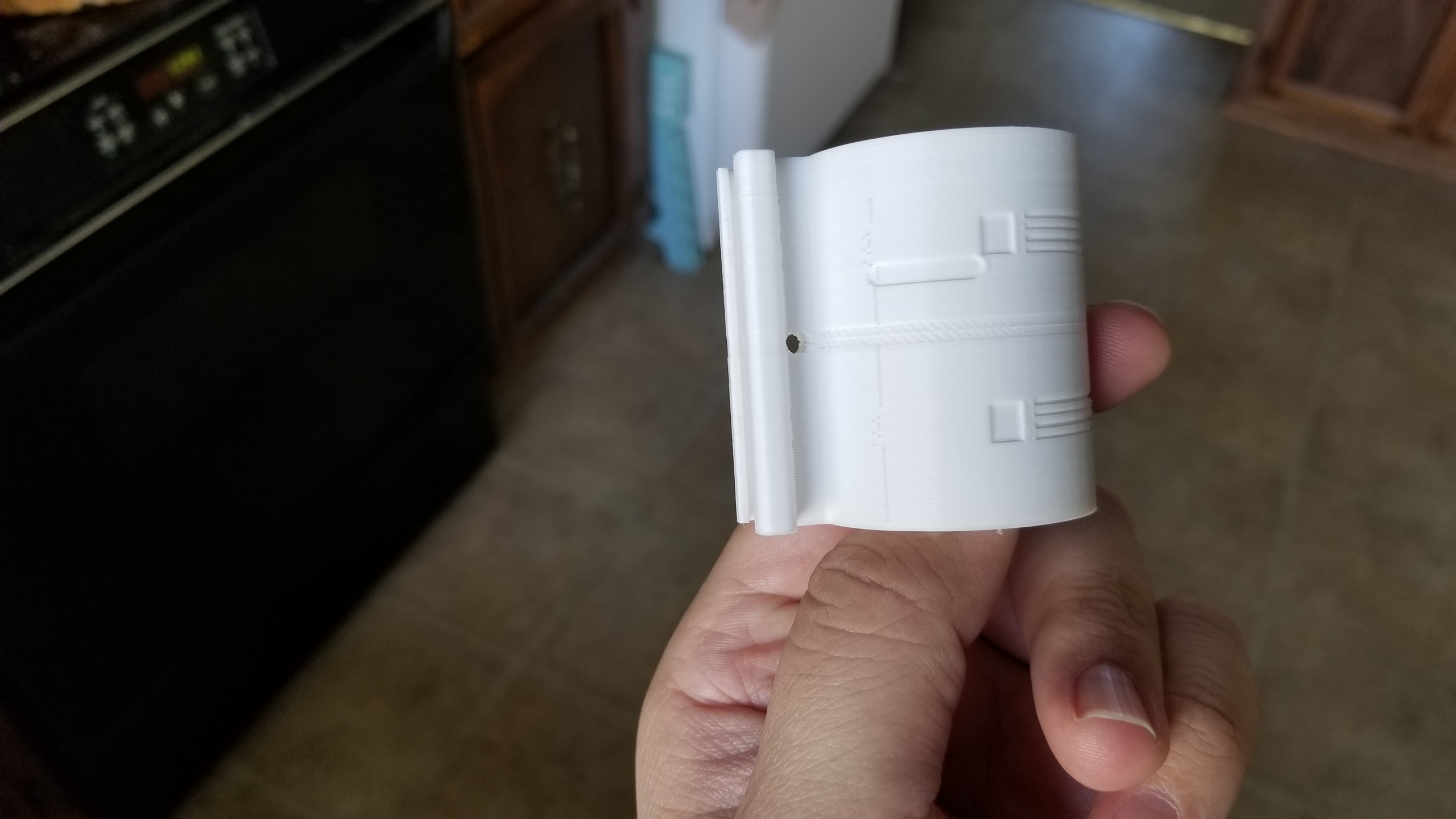

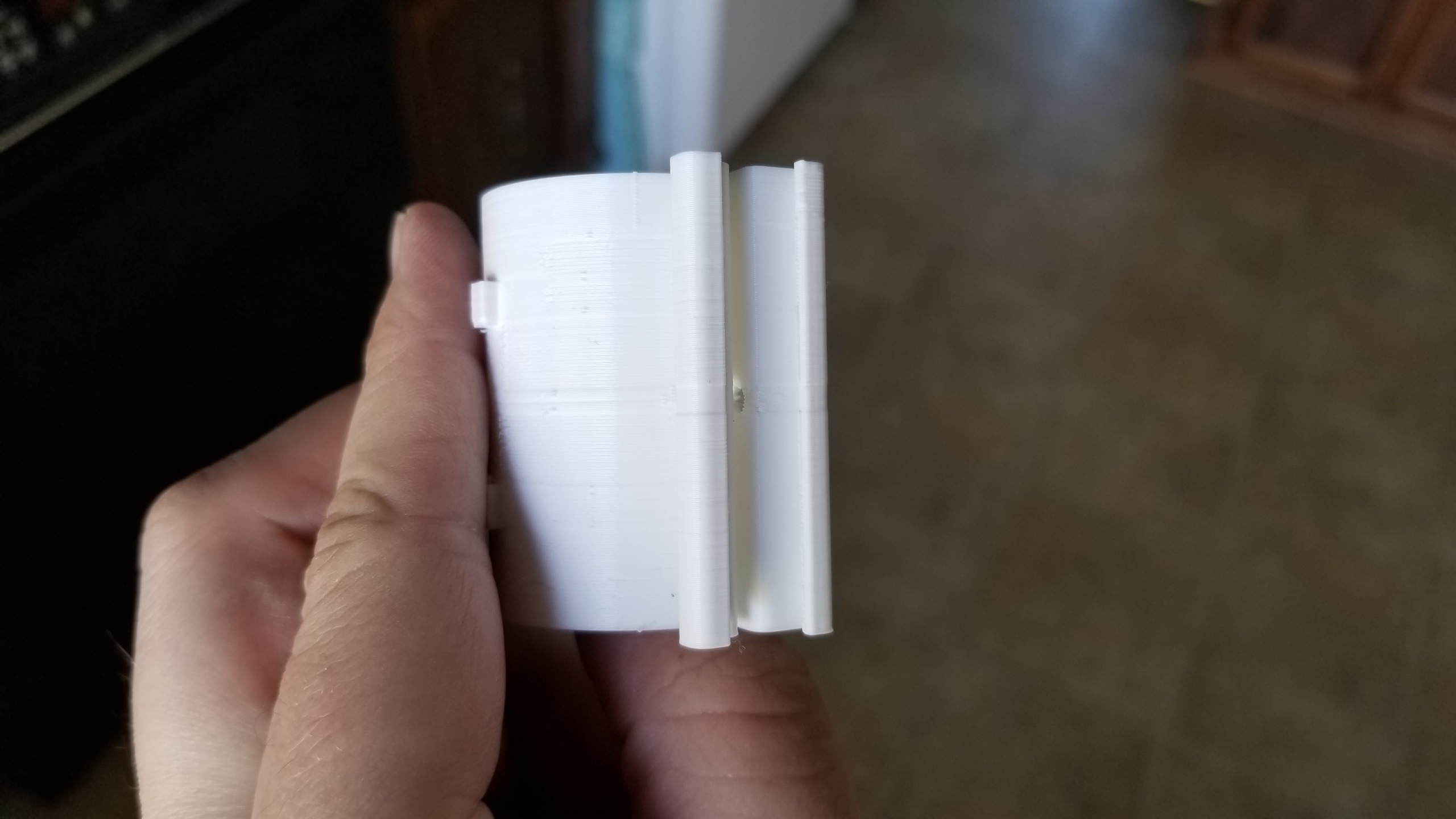

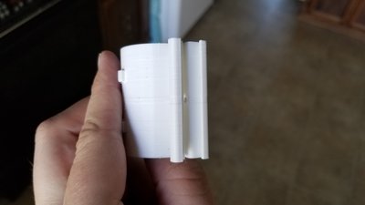

I'm printing some parts on my Flashforge Creator Pro 2016 and keep seeing this weird banding issue around any walls that have holes in them. It also seems to happen when the outline of an object changes, where detail either sticks out further or cuts inward. It only lasts from the bottom of the hole to the top, and stretches almost all the way around the part. Photos attached. This is not the only part this happens on, any with a change in outline with respect to Z axis result in this defect.

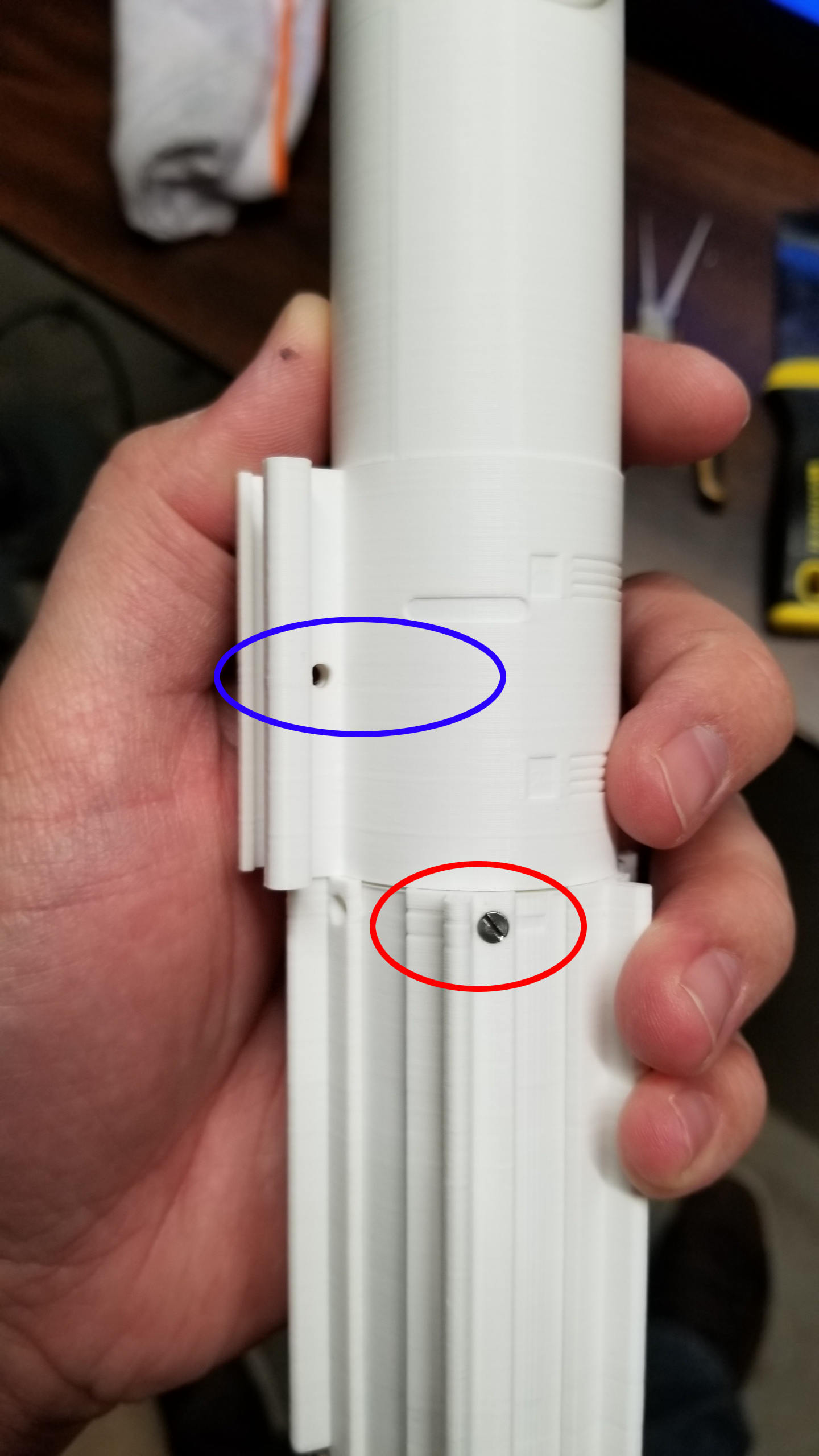

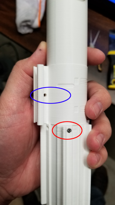

Attached is another example of the issue on a couple other parts. Notice the areas circled in red - the effect is present only at heights where there are holes in the wall. And some effect in the area in blue, though not as bad as on the part in previous posts. In fact, the other side of the blue area is raised instead of recessed, almost like a layer shift but only at the heights where the details are. Everything returns to normal once getting past the holes/recesses.
Any ideas, anyone at all?

Attached a picture of my test- bloc for bridging and hole; in the worst case, a band ist as large as the hole wide. Theoretically the bridge has similiar conditions as the hole, but I have never seen a band there!
