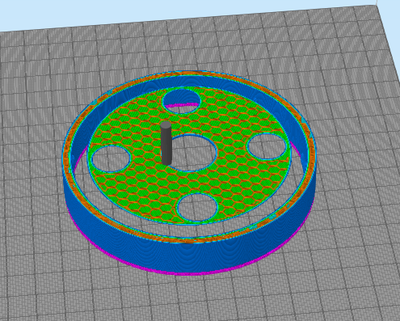

I forgot to check the "add support" box in the factory file yesterday. As you noticed, the object is impossible to print without support... my fault!
2nd fault: Unfortunately I selected the wrong material.... But most settings should be the same!
This is the final factory file (double checked support and material settings - this is 100% the version of the picture in Post #1):
http://www.zersan.de/3d/top/big_lid_new2.factory
______________________________________________
dkightley wrote:Firstly, the pictures of the raft surface may not be the surface of the result of the latest factory file. They look like the result of slicing with a pre v4 version of S3D. If they were a prev4 print, then its a waste of time trying to relate a surface finish of a pre-v4 print with v4 software settings!
I use the latest v4 Version.
Surely you thought it's a pre v4 factory file because of the big raft.
S3D just creates that small raft on your picture if you print without support.
So.. It was my fault because I forgot to check to "add support" box.. Sorry about that!
horst.w wrote:But the dimension is big (inch?) – approximately 95 x 95 x37 mm, thats right?
You are right. It's a quite big object. Dimensions in mm are correct.
horst.w wrote:[...] your Infill is set to 150 % ExtrusionWidth [...]
Uhm... this is a very old value..
When I started with S3D I had some issues with weak infill structures. Seemed like printer extruded not enough material for the infill.
In the S3D quality guide I found a workaround to increase the infill extrusion width to fix that issue:
https://www.simplify3d.com/support/prin ... eak-infill
dkightley wrote:The infill width is NOT an expression of the amount of plastic extruded....
Are you really sure about that? The quality guide said it WILL influence the amount of material..
One more thing:
dkightley wrote:I get the feeling we're fighting against continually changing printer settings....and we're never going to be able to suggest the right tweaks to make!!!
I'm really sorry about that.. I don't want to steal your time... :/
I'm not playing around with printer settings.. I just forgot to add the support and unfortunately I forgot that I changed the printed material meanwhile...
As said above.. the current factory file shows 100% my actual settings
So you both think my top layers could be improved by reduce the infill extrusion width?
