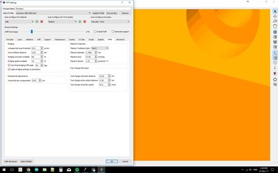

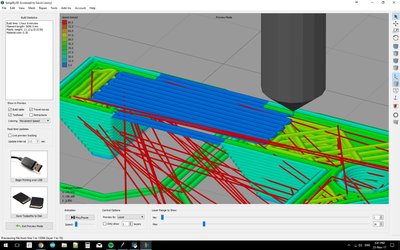

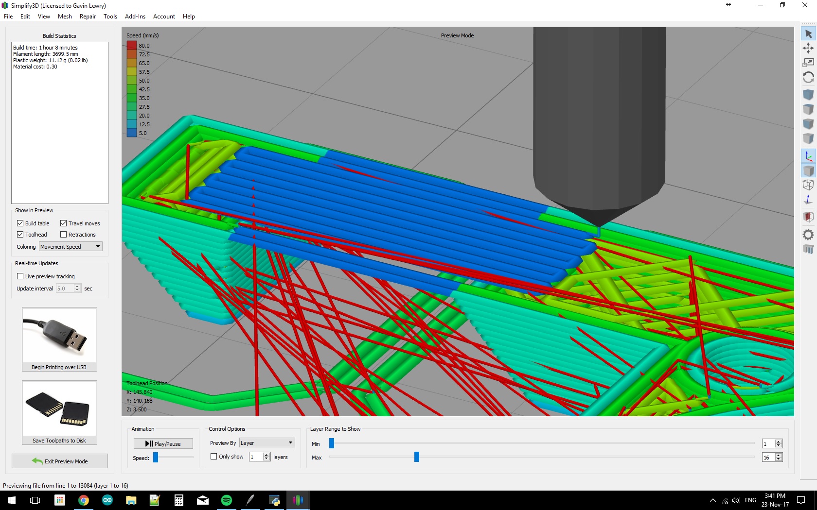

hi guys, went searching for my exact issue and couldnt find it anywhere.
Anyways, when rendering a bridged perimeter Simplify3d doesnt apply ALL of the bridging settings to the perimeters......specifically the extra inflation distance
as per below
biggest drama about this is the nozzle doesnt have time to ease the pressure inside before reaching the bridge resulting in a drooping perimeter, ontop of that my fan isnt fully upto speed till the nozzle is a few mm's into bridge also adding to the problem.
if the inflation distance was honoured by the perimeters i feel theyd be time for the process to be ready for the bridge and a non droopy perimeter.
**for clarity the infill part of the bridge prints perfectly fine**

what info, yes it behaves exactly like you said, yes it would probbly be better if perimeters would also use the inflation distance... it's waaaaaaaaaaaaaaaay better then it was, not perfect.. maybe they fix it in future, maybe they don't.. not that any of us have any pull to make them do anything :D

So it could possibly be classed as a bug I guess, but maybe a few more parameters in the process settings would allow people to choose how the perimeter behaves. I hope the developers read through this as im really back where we were with v3.1 and sticking supports under the perimeters when bridging. Not ideal
