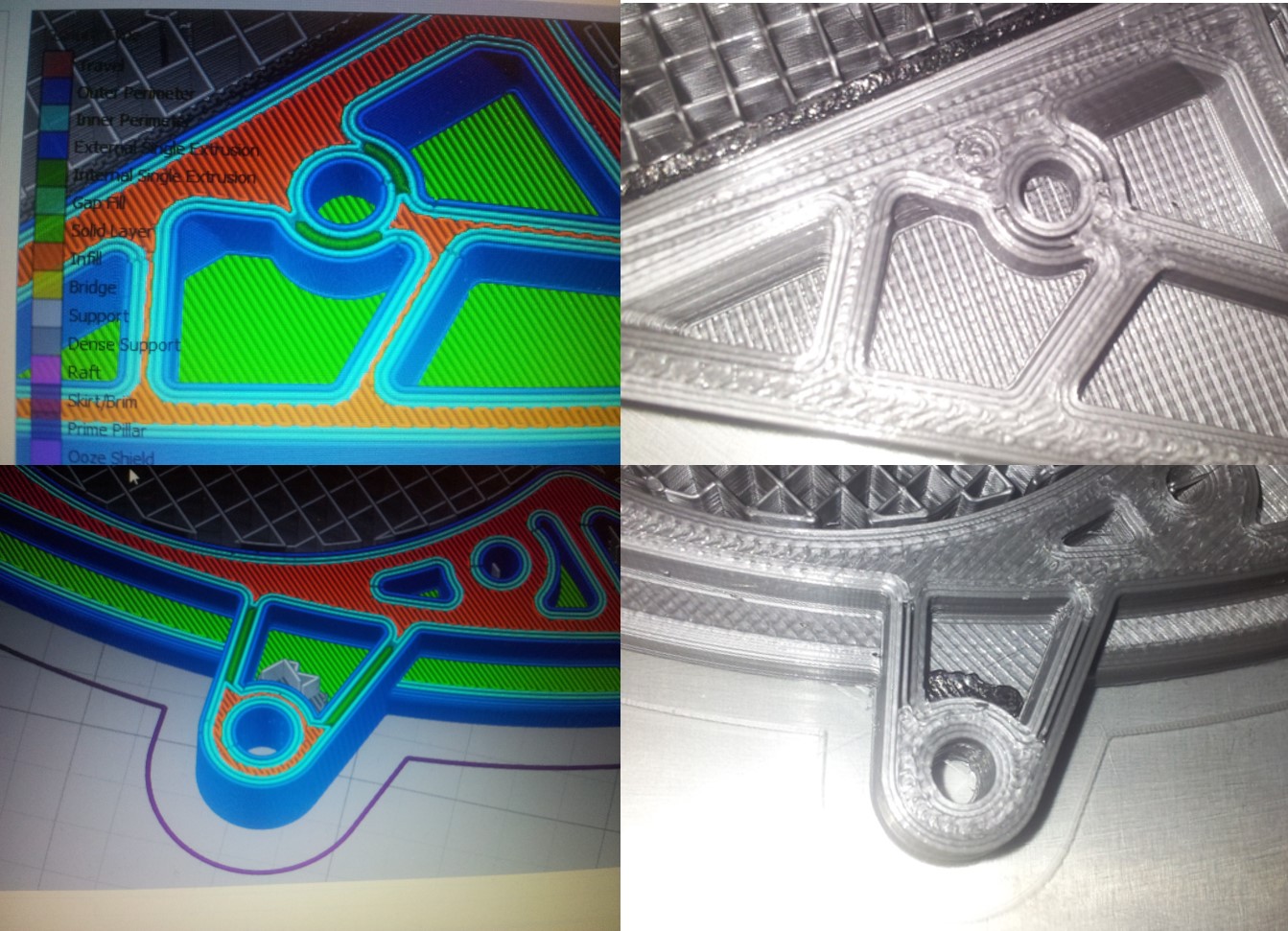

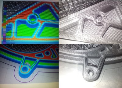

Hi guys... I do have an issue with single extrusion fill.
As everything else is fine (no under or over extrusion on any surfaces) and even single extrusion walls are looking good (at least on first subjective look):
--> I dont get the single extrusion fill working. It is always severe underextruded. Is it possible that I checked any option that might prevent a proper single extrusion fill??
Attached a picture (left: process, right: outcome)

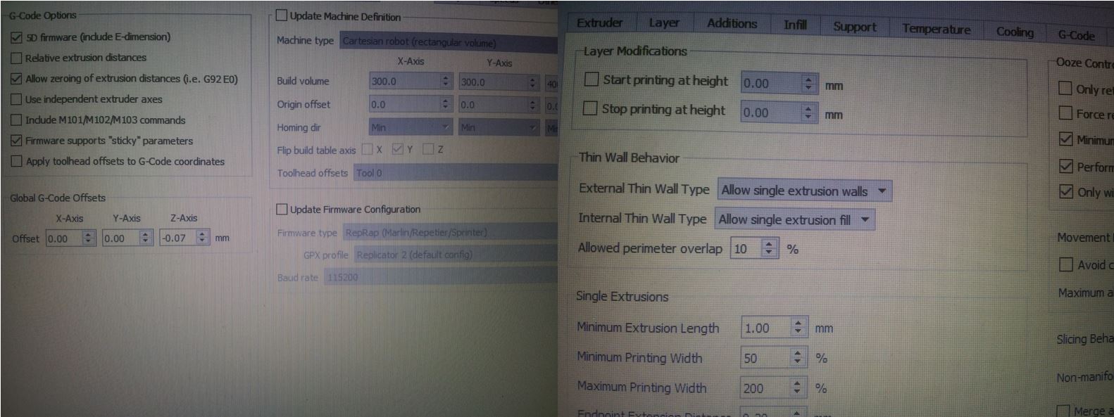

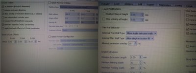

My single extrusion setting

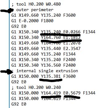

As far as i know it does the infills by virtually changeing the nozzle diameter and with it the extrusion width.
I shortly examined a gcode and saw that for the single extrusions there are "tool-switches" from one to an other with different diameters...

BANG --> I will check that directly when arriving home.
My problem: I am printing with a Y-piece and am switching tools with a tool change script. Maybe this screws up the single extrusion feature.
If this is the case I do hopefully find a workaround...

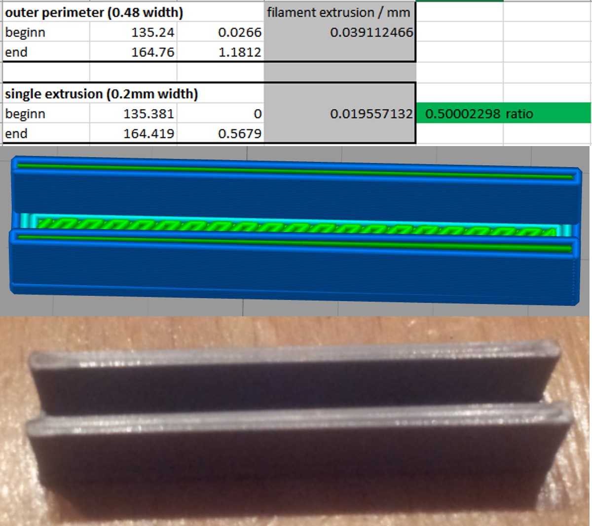

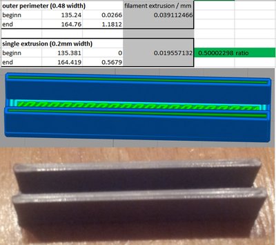

ok...just started a simple geometry. It's working fine with single extrusion which is smaller than standard width (see pictures)
--> I try to get out where the difference to my "real" model is. It seems that he tries to realize a single extrude which is bigger than one standard width
single extrusion success_gcode.jpg (43.78 KiB) Viewed 5948 times

blackbird2016 wrote:I shortly examined a gcode and saw that for the single extrusions there are "tool-switches" from one to an other with different diameters...
It isn't an actual tool change command. It just changes the E-values for how much plastic will be extruded. So even if you are using a custom tool change script, this won't affect you.
