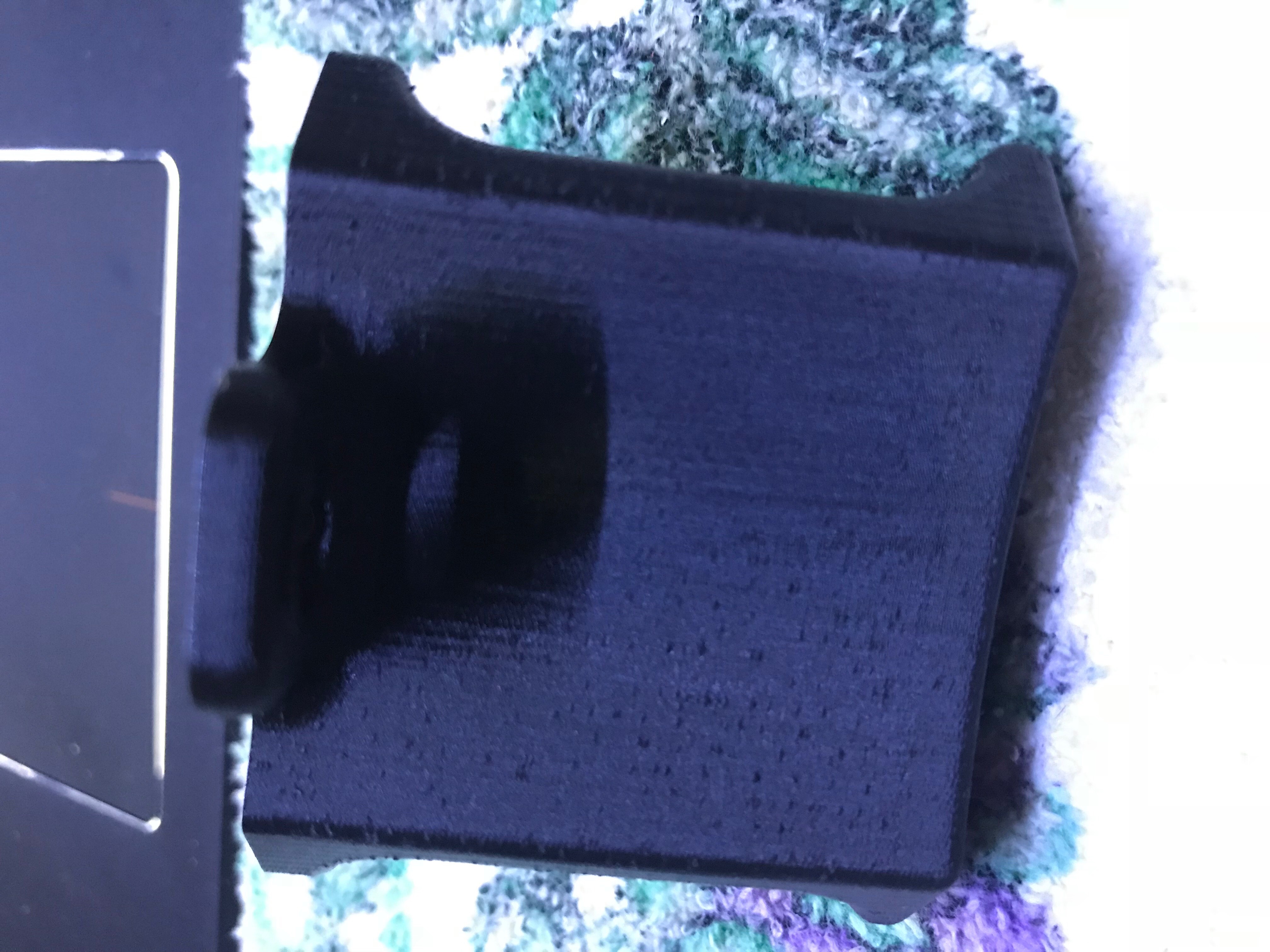

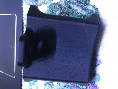

Stuttering causing tiny blobs on parts
I just started using S3D about 2 weeks ago and I have a Kossel Mini that is running a Rumba board with DVR 8825's. The drivers are properly tuned and I have had great prints before running slicers other than S3D. I am seeing vary tiny blobs on the outside of my parts since i started slicing with S3D. I have printed the same model with MatterControl and with S3D using settings that are as similar as i can get them and the MC print comes out with a much better finish.
After watching the printer vary carefully I found that that the Hot End was stuttering vary sightly (almost couldn't see it happen but could hear it) and leaving a tiny blob on the finish of my parts. These blobs cause a rough finish that looks awful. I have inspected the gcode its self and first found that S3D was sending Z Height and Feedrate command with each line of movement. I turned on "Sticky" Parameters in the Gcode options and this helped some but did not get rid of the stuttering. I also have compaired it to the gcode that the MatterControl output and found that S3D programs for much smaller movements.

The extruder type is a Bowden and the Teflon tube is approximately 350 mm long. I am using AIO PLA (that I have had good results with before). I have seen the Troubleshooting guide and found no answer to my issue. The blobs are not happening at the beginning or end of the layer but throughout.
I believe that with S3D and the way it slices it puts out twice as many points (over other slicers) for the movement of the hotend trying to make the best curve possible. This causes the 8bit processor to have to make many more calculations for movement than if the points were farther apart. Making all those calculations causes the mini pauses which in turn causes the blobs. These blobs only appear on curved surface and not on any straight ones.
