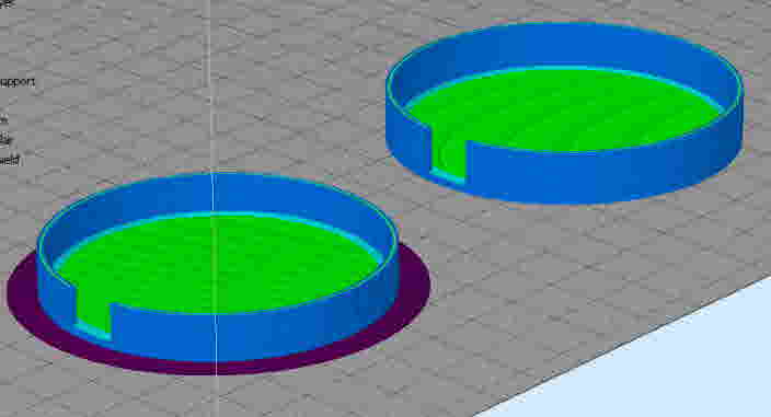

It looks like my parts are far enough apart, but the inner pieces are nested within a rectangular other piece.
Does nesting pieces make the brim/skirt turn off also?
Boby
Joined: Fri Sep 15, 2017 6:08 pm
Re: Multiple processes not working
Thanks, for me it solved my problem. But the distance you have to move the piece away is much farther than ever expected.
I guess S3D needs some improvement here - or at least telling the user "hey, I'm not generating the brim you ordered because you objects are too close to each other". Just to leave it away without any hint is not a fair move.
