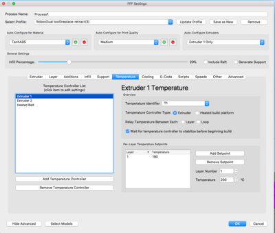

I am trying to understand why if I create a process, select a profile with known temperature setpoints for layer 1 & 2, why selecting another extruder type say Extruder 1, Extruder 2 or All extruders, seems to corrupt the profiles temperature setpoints, and mine keeps defaulting back to 190ºC, when it should be 245,235ºC.
At first I thought it was firmware related, but it does it now whenever I switch extruders, and even using the Dual extrusion Wizard I am still seeing this.

Solved, I just deleted them all, after saving one. :)
Then I checked the .frm and edited the FFF profile by hand and re-imported them both, and problem solved, so not sure why it was happening, having found the affected area of code, but it's history now.
