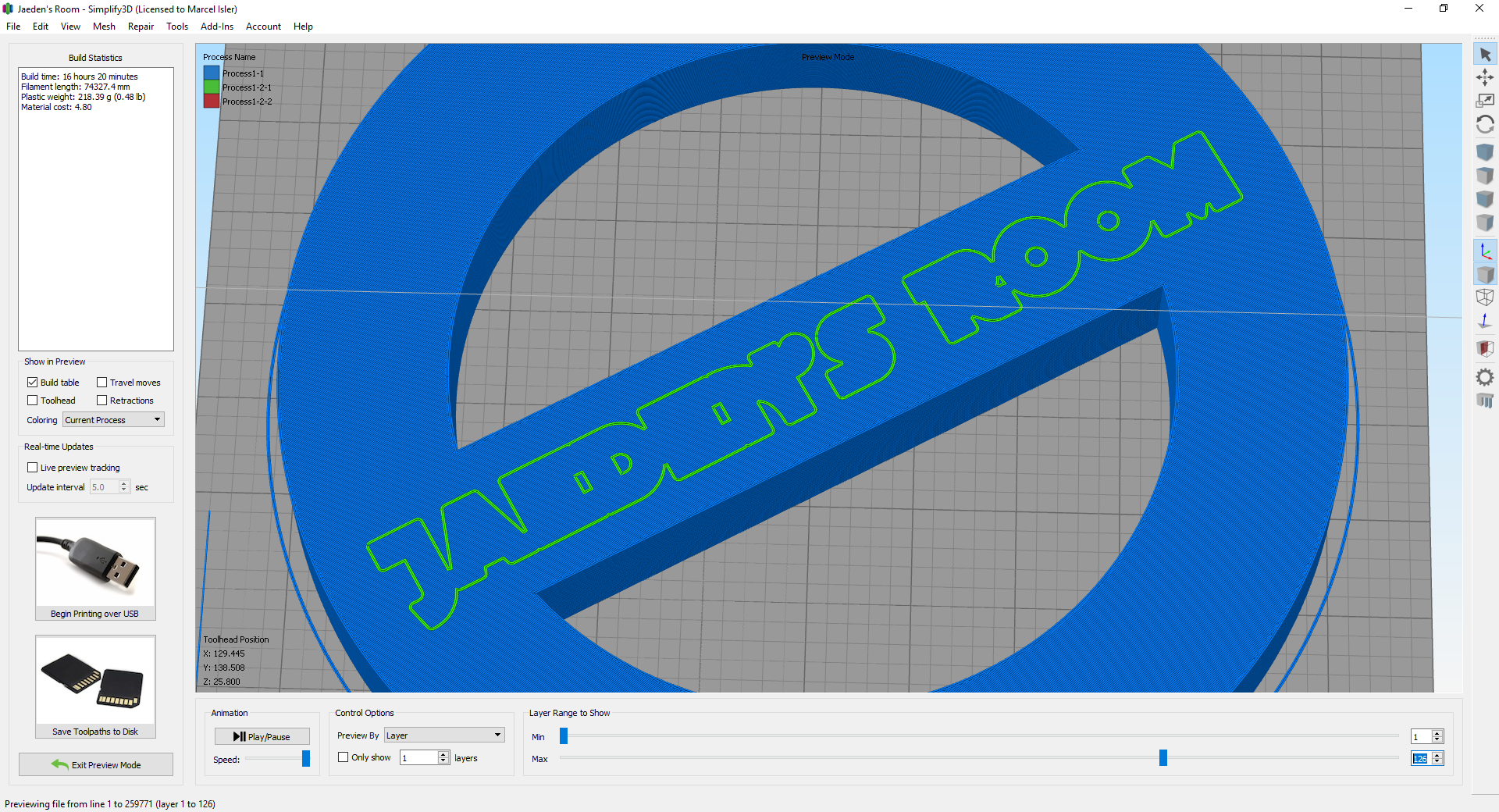

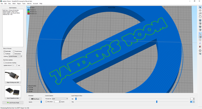

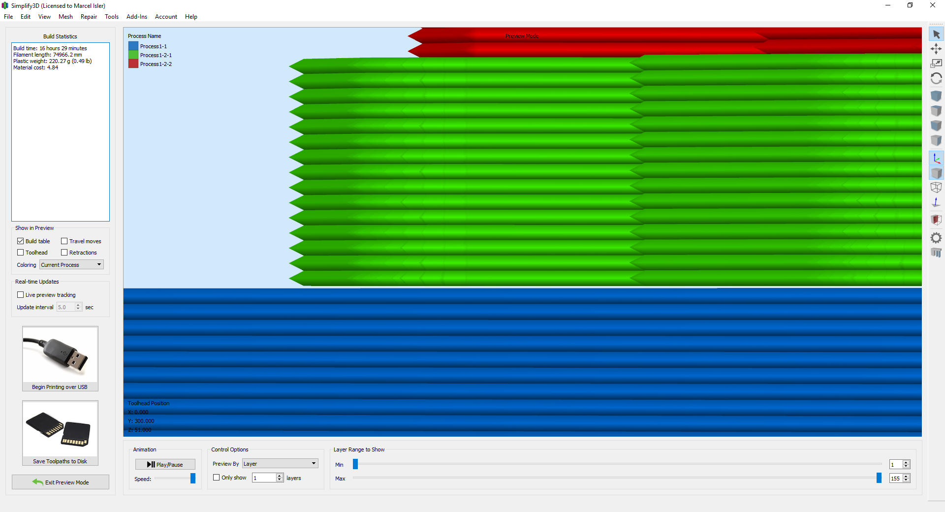

Hi there,
I just upgraded from 4.0.0 to 4.0.1 because I had an issue where the older version left a 0.04mm gap between the first and second process.
This has been fixed in 4.0.1, but now I don't get infill for the first layer of the second and third process which was working fine under 4.0.0
I have my factory setup with three processes and three objects that are stacked on top of each other. I plan to include filament change codes at the beginning of the second and third process in the gcode. I do want to have a full top layer below and above the process change as that gives a nicer looking surface of the exposed part of the lower layer.

I don't know if this is what you are getting but I recently found out that in the new version the "Top" and "Bottom" layer settings only affect the actual top and bottom of the overall part. They no longer apply to each process but just the overall part
I was trying to make a solid area in the middle of a part with two process and using top and bottom layers to do it but it wouldn't work.
My solution was to add a process for the area I wanted solid and use the include solid diaphragm every x layers and set it to 1.
I believe Doug clued me into this. Means making extra processes but it worked good.
So, maybe your issue and maybe not!!
