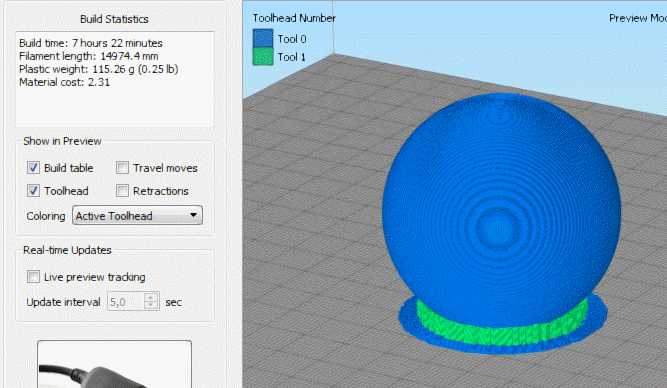

So as Member 24c wrote, it is easy to realize;
prepare your print as usual;
add a second process (Add in the main window)
choice it, the 2nd settings window opens and go to Support
activate the support and do the settings ( speeds , temps ...)
choice there the 2nd extruder for support material
close the window, click to Prepare Print > all processes
ignore the warning message ...
in the preview choice the option " ... Coloring > Active Extruder
the Preview will show what will be printed with extruder 1 or 2
Regards

I'm agree with you, the way is not clear and not really logical for the user. But in consequence it is not a real double printing as the message mentioned, because the 2nd process is different to the support printing. And only these differences will be printed.
The 2nd process is a copy of the 1st process and the activation of the support with the 2nd extruder is only available for the 2nd process. So the program can filter out easy identical printing steps. Keep in mind that the message occures before the slicing begins. At this moment the program cann't know what exactly is to do, it knows only that there are 2 processes with a relationship to one and the same object.
The same message occures when you have to print 2 or more objects, each one with an own process and miss to select the objects to their process, will say, all processes would print all objects at the same time. Thats a real fault and the program doesn't filter out duplicates and it makes big trouble. Similar situation is the overlaying of stop - start settings for 2 processes.

I think the solution is much simpler! If you open the stock FF Creator Dual profile, select the "Both Extruders" option at the top (since you are using both toolheads). Then go to the Supports tab and change the support extruder to the one you want to use for the supports. Last, go to the Speeds tab and adjust the support structure underspeed to control the speed of the supports.
This way you can print the supports with a different extruder and control the exact speed that is used for the supports.
