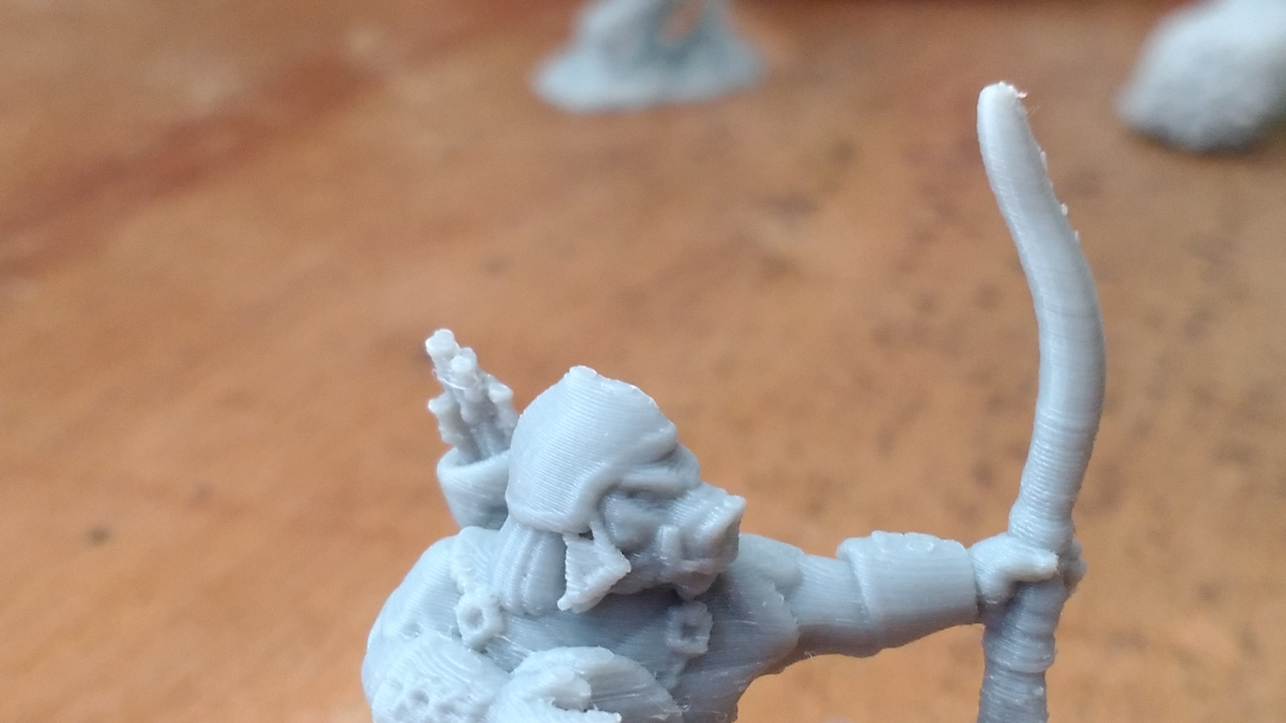

Roguenorm
Joined: Sat Mar 31, 2018 5:38 pm
Re: Look for help on fine detail distortions
So I have been trying to do the exact same thing with my Qidi Tech 1! I've managed to get the settings dialed in pretty well for single extrusion high resolution (0.1 mm) prints without supports. Take a look at the images I've posted here.
I have also attached my factory file. Two things to note with that. 1) the "force retraction between layers" in the Advanced tab is turned on. This may have helped, but also resulted in the the filament getting stripped a lot of times and prints failing. I would turn it off. 2) I was using the right extruder for these prints because my left extruder closer to the fan was having issues. Likely better to switch it to the left extruder.
Now I'm trying to figure out how to use PVA as support for the minis. THAT is not going nearly so well. ;)
