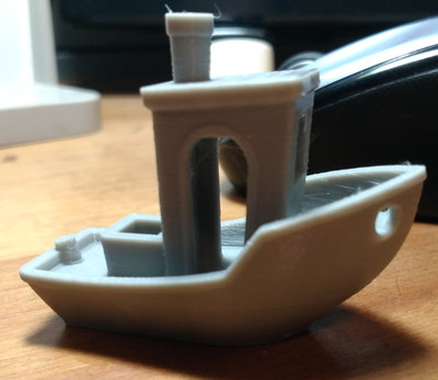

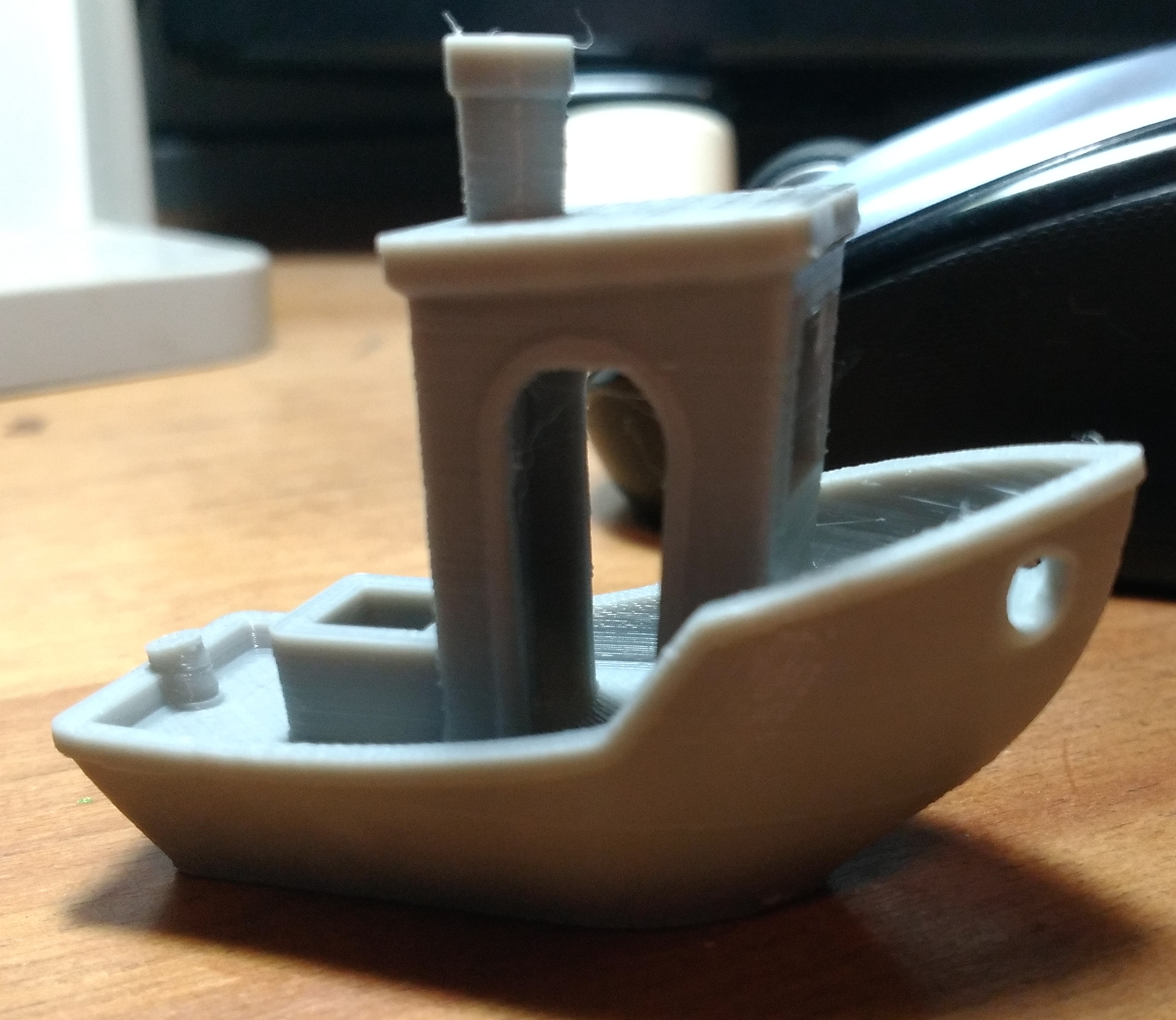

Also, had a chance to play with the printer a bunch today, and realized that, like Inigo Montoya, I had to go back to the beginning. I started from the original S3D supplied profile for the Qidi Tech and its PLA (right) PVA (left) materials. I tweaked the settings very slightly for the PLA and printed the benchy at 0.1 mm and it turned out very well. I have attached that factory file here and a picture of benchy. I feel this is a better group of settings for you to be starting from. The key here is levelling the build plate. I have a digital indicator that I use to get exact leveling, and use a 0.4 mm feeler gauge for the distance between the hot end and the bed.
