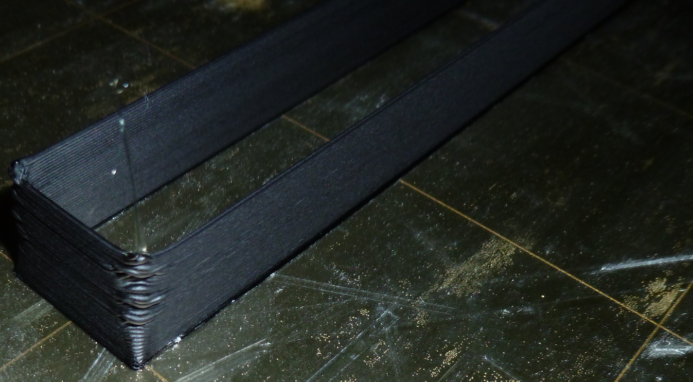

Here's a test object that I'm printing at 3000mm/min using a 0.8mm volcano nozzle and PETG filament and linear advance K=20. Layer height is 0.4mm and extrusion width is 0.96mm. The corners look acceptable to me:

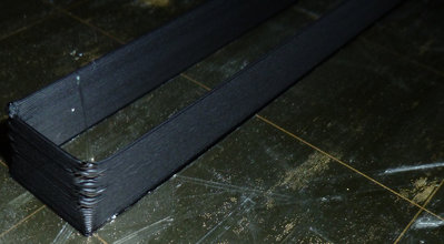

However, if I increase the speed to 4000mm/min, the rest of the model stays fine, but the corners look terrible:
What can I do to keep decent corners a higher speeds?

This looks for me more like a cooling problem. Did you turn your fan on? I mean 66mm/s isn't that fast, but since you are printing only perimeters (or Vase Mode) each layer takes not that long, and therefor the filament from the layer below isn't cooled down enough.

I'd call that going too fast.
You might improve the results by increasing the nozzle temperature which will reduce the viscosity, elasticity, and tensile strength of the extruded bead and might improve the layer bonding.

It doesn't seem to be exceptional fast but one thing is that PETG doesn't like to be printed fast. I am guessing you are on a MK2 or MK3?
I normally print PETG at a max of 40mm/s on my MK2.

wirlybird wrote: ↑Fri Jun 22, 2018 7:05 am I normally print PETG at a max of 40mm/s on my MK2.
Same on my Snapmaker. and even then the corners are a little rough.

I'd agree there......but having looked at the nozzle size I begin to wonder if the hot end is not coping properly with the amount of plastic it is being asked to heat and extrude. I think its a flow rate issue as opposed to a speed issue!

Coming back to this topic with some additional experience, I'd also suggest running an extrusion width about 1.2 x of the nozzle diameter. The plastic expands naturally when it exits the nozzle. Trying to maintain an extrusion width equal to the nozzle diameter requires the stream to be stretched a bit and can pull in on the corners.
