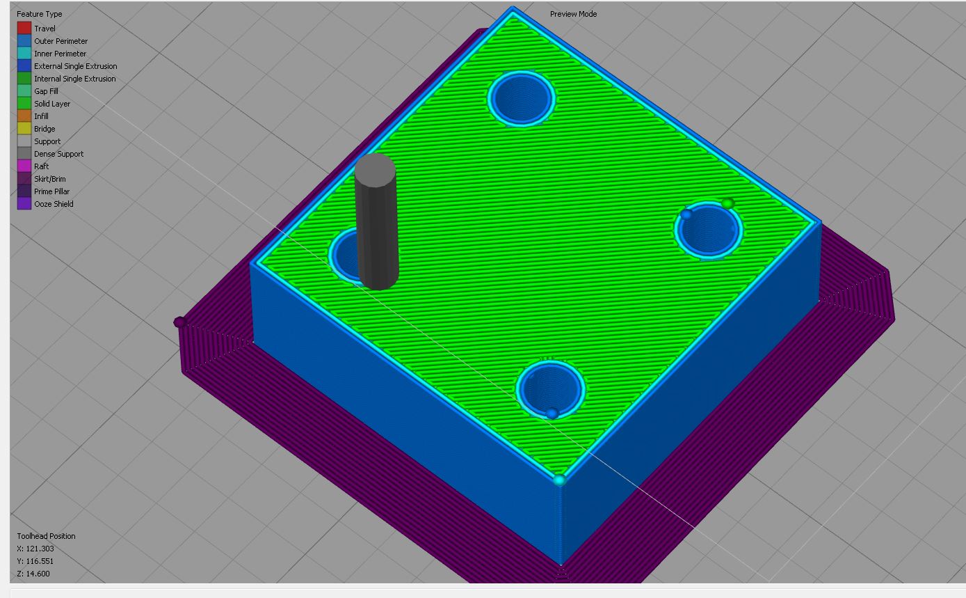

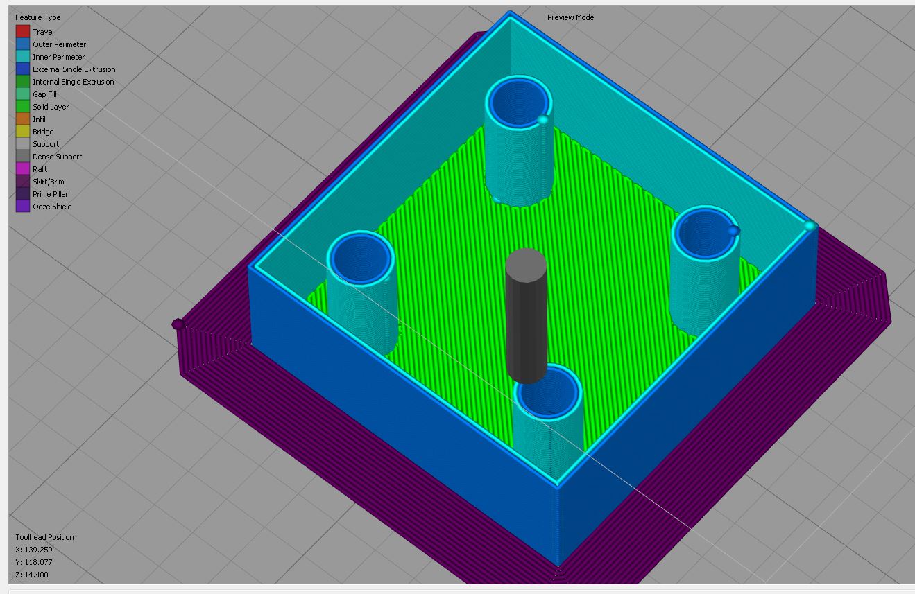

Three images.
First shows the model on the layer before the top of the hollow box is printed.
The second one shows where I thought it should be a 'bridging layer' but is shown (and printed) as a solid layer.
I expected S3D to highlight that layer in yellow not green
And final one of how Silc3r PE bridging detection handled it and shows it as a bridging layer (which is what I used to use before buying S3D).
Last hollow layer.
Last hollow layer.
Bridging layer should be this one ?
Tested bridging detection with Slic3r PE software.

In my opinion for S3D these are not bridges but top solid layers.
Just the missing infill makes them to bridges, kind of.
But S3D does not recognize it as bridge for the 1st solid top layer is no outer surface.
btw. Even if there were a reason to print completely without infill,
one could increase the amount of top solid layers to get an even surface.
Or better use either multiple processes with different fan speeds or
determine a fan speed per layer using the print preview.
S3D recognizing that "interior-bridge" as a bridge and applying the fan speeds would be preferably, though....
