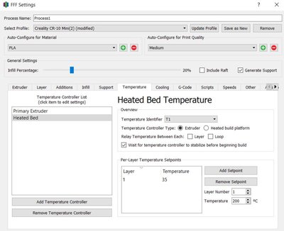

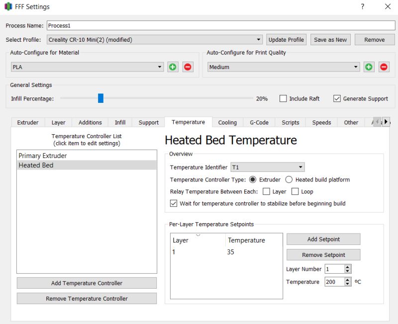

Just downloaded and installed S3D and on the most part got everything set up and printed out a couple things. The only thing that I can't get to work and it's probably something I'm doing wrong is to get the bed temp set while in the FFF Setting/Temperature. I got the extruder set and working but no matter what I've tried so far I can't get the bed temp to come on when I start a print and have to manually set it once the print has started.
When I start a print, the extruder starts off at 215C but the bed stays at 0°C
bed temp set
bed temp set

You have your heated bed set as a Type of "Extruder"

Thanks Doug, sometimes it takes another eyeball to notice something so simple. :D
