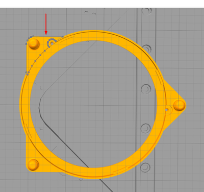

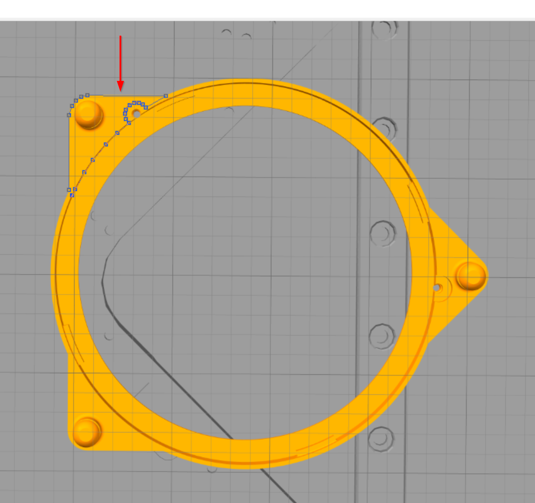

Well what if we would be able to define the footprint of the support structure using a path based on anchor points. We would all save a tone of time AND give us the option to design precise, silky smooth supports rather than the jagged square supports we have now.
The workflow could look like this:
1. Place the model, center and arrange, whatever.
2. Tools > Customize Support Structures > Draw support from footprint
3. Bottom view is activated, showing the "footprint" of the placed model above. The footprint is basically a "drop shadow" of the model and NOT just the part of the model that touches the print bed.
4. Only within this footprint we get to set anchor points, defining the outline of the support we want to create.
5. With these anchor points we can draw a path, as soon as the path is closed it becomes the base of a new support structure.
6. A diolog box opens, giving you some options:
- Smooth path with the option to define a corner radius, live preview when adjusting the radius.
- Create support from build plate untill the first encounter with the placed model, or;
- Create support from build plate up to the top of the model.
7. Hit "Generate support"
