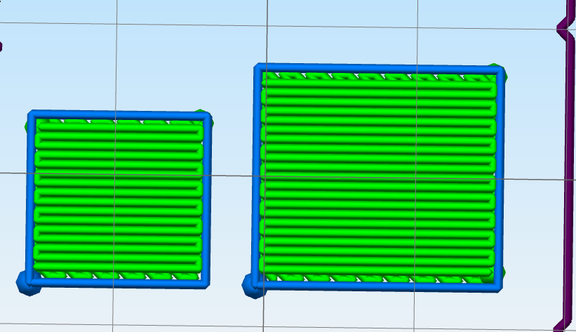

Hello,
I'm new both here and to s3d.
I'm having a little bit of trouble getting my first layer sliced properly.
I have gaps between the perimeters and infill.
What am I doing wrong?
The gaps are not present when I use 45° infill, but I need these lines to be horizontal.
Thanks!
Re: First layer infill gaps
You need to add some Outline Overlap to make the infill cover all of the area. I suggest you start with 40%.....and increase if necessary if the gaps don't go.

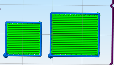

Thanks, I've made them to disappear on 60% overlap.
But does not make this the perimeters to bulge on the other sides ?
