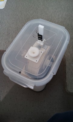

I use these with Rice in the bottom.
Can feed directly into machine...
I store excess and partially used filament in them and larger bins without the spool/feed stuff attached the one in photo... But, all have Rice in the bottom.

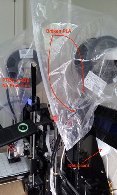

Been using Ziplocs for 4 yrs but, PLA always breaks before spool is finished (If leaving it on the machine).
No problem if storing in bin.
No problem with ABS or PETG

How do you know when the desiccant is saturated? Looks like you are using clear silica. That's also odd because I would expect the PETG to exhibit issues before PLA, unless your bag was leaky. Do you pressurize the bags to test for holes periodically?
