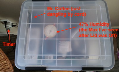

Thanks Greybeard, for sharing your idea with the picture. It helped me also.

Geeks are always tweaking…
I had an idea for a bread proofing (raising) bin and was so pleased with results that I transferred the idea to storing filament.
Simple concept: use a Mr. Coffee mug warmer in large tote for filament!
Photo attached:
It’s on a timer (On 1 hr, Off 1 hr).
Mr. Coffee uses 17 watts. So, that’s 204 Watts for 12 hr’s of On time. At $0.15/kW, the cost to run it is insignificant.
It keeps the box at < 45% humidity and I haven’t seen broken filament in months
