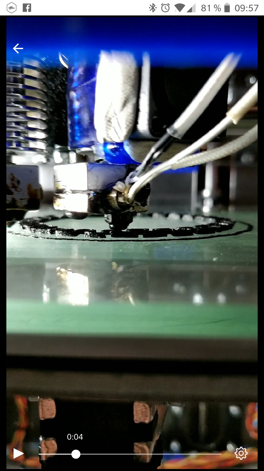

Hi I have a similar problem when I'm printing with carbon fiber nylon on my k8400.
I have printed a calibration box and I'm not overextruding.
The filament builds up on the tip and after a while it drops off and makes a ugly layer.
See picture
Thanks
