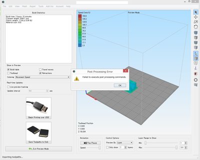

If preservation operation of a tool path is carried out, an error will occur.

An error occurs in Ver4.1.
I do not generate in Ver4.0.

Can you attach your factory file? It might have something to do with your post-processing script judging by the error.
I've already exported and printed several parts from V4.1, so there must be something different in your settings/scripts that causing it..

Probably totally unrelated, but I found that Kaspersky AV was getting a bit enthusiastic and intercepting disk writes when slicing with S3D earlier in the year. Writes would randomly fail.
Removing KAV solved that issue.

I attach err.factory.
Does an error reappear there?

In the latest 4.1.2 release, our team fixed a bug with post processing scripts which was brought up in another thread. It is our hope that the issue reported here which seems related was also resolved. This was just one of many improvements to the software. All of which are detailed on our Release Notes page.
