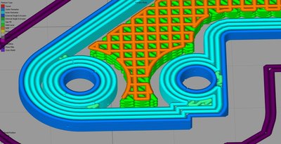

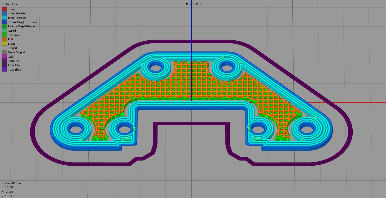

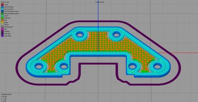

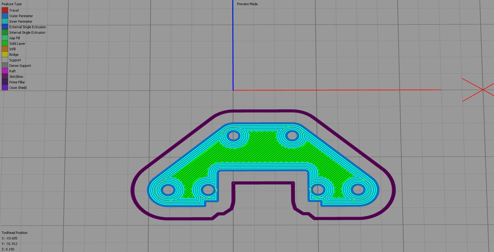

Issue: missing inner perimeters if object is in the center.
Case 1: One object only - object is centered by "Center and Arrange" button-> inner perimeters are missing on first 6 layers

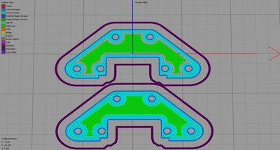

Case 2: Two objects - one is in the center, the second (of the same parttype ) is not in center: missing inner perimeters on first layer only on centered model

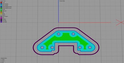

Case 3: One object only - object is out of center: inner perimeters are OK
Case 4: Two objects - none of them are centered: inner perimeters are OK
Exactly the same process, only imported or removed one more object and/or moved the object out of center.
This was the first part I sliced with my brand new Simplify3D software... Not the best introduction.
(Besides that issue, the first layer is not solid and has gaps between the lines, which was never an issue for me in the past with any of the slicers I used. That still can be an S3D learning curve topic for me, so not claiming yet...)

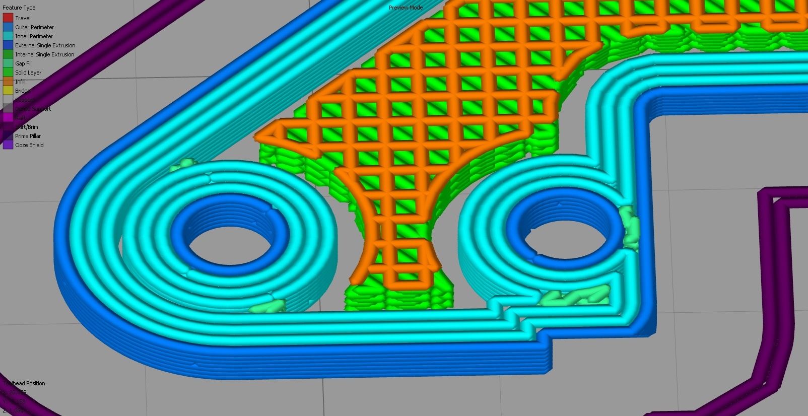

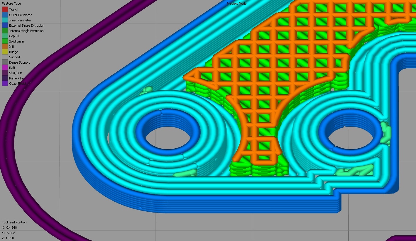

Surely a bug!

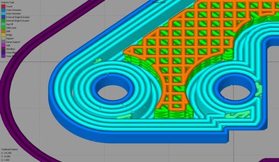

I have extracted the STL out of your factory and imported it into my own settings. There is NO Problem.
You have set 6 permeter lines and than the perimeters reach to the holes and have collision with the perimeters of the holes. Thats all.
Reducing the perimeters (3) solve the problem for the moment.
It seems to me it is the same issue I have mentioned here: viewtopic.php?f=9&t=11714 where the subject is "only" the brim. But there is also a collision of the brim-lines between 2 objects and V 4.1 let the space empty.

I can reproduce the issue in my settings, when I raise the perimeters to 5 and more.
H.

Misterious!

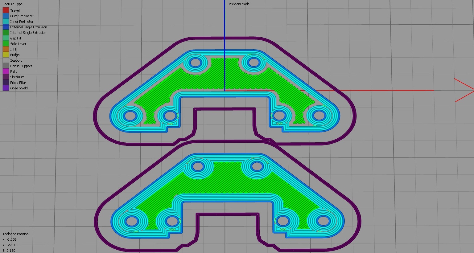

I can' t reproduce it now not outside the center, but Centered and Arranged the issue comes up again.
Therefore is new, when I center it and than turn for 90 degrees the issue is disappeared.
I give up! Turning back to its old position, there is no issue!
H.
Re: Missing inner perimeters if object is in the center
This is part of the new and improved top/bottom solid layers and perimeter processing! See this thread for further information: viewtopic.php?f=9&t=11671
The workaround is to go back to v4.0.1
