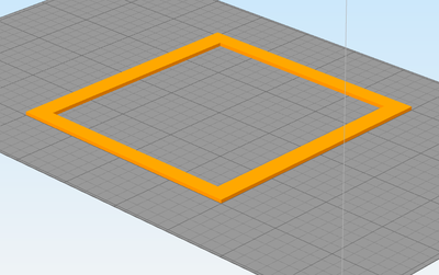

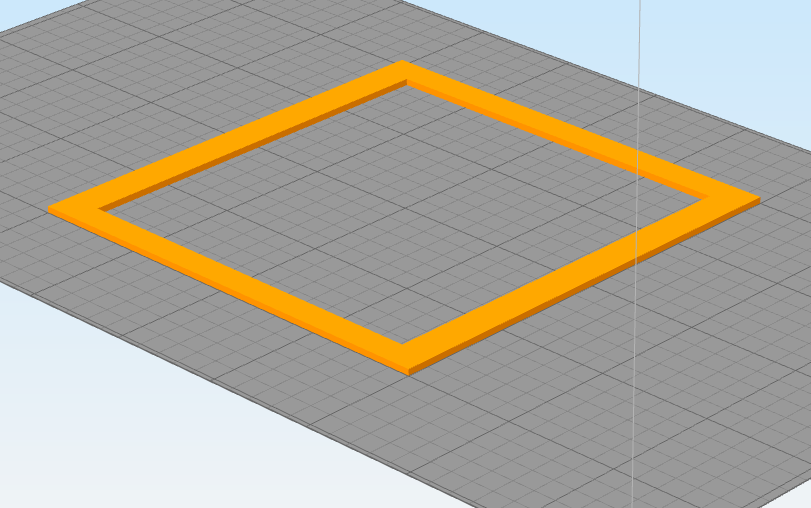

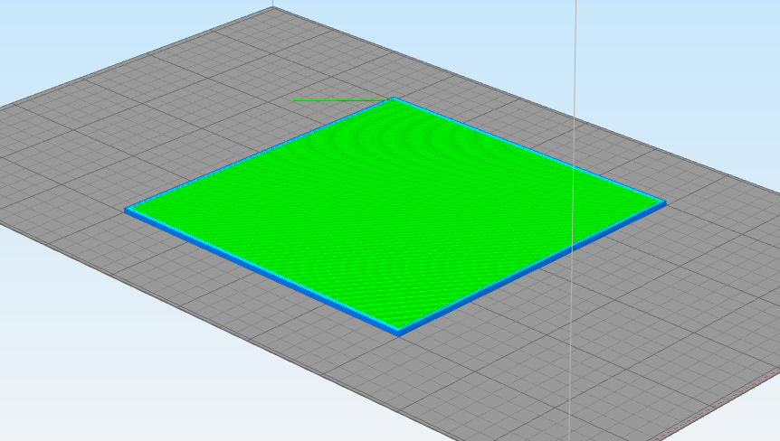

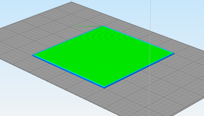

frame rendered as square
A frame model (square with a cutout square) rendered as a square without the cutout for my printrbot simple metal. It rendered correctly for my flashforge creator dual. I've attached screenshots to show the problem.

You also might want to check in the Advanced tab of the Process Settings and make sure that "Merge all outlines into a single solid model" is not checked.

Re: frame rendered as square
It was checked on the printer with the problem and not on the other. I will assume that was the problem. Thanks.
That particular setting is intended to be used for models that are not solid when using the vase mode option. For example, if you had a hollow cylinder that you wanted to print with one continuous perimeter like vase mode allows for then you would check this box to make sure that vase mode will work as intended.
