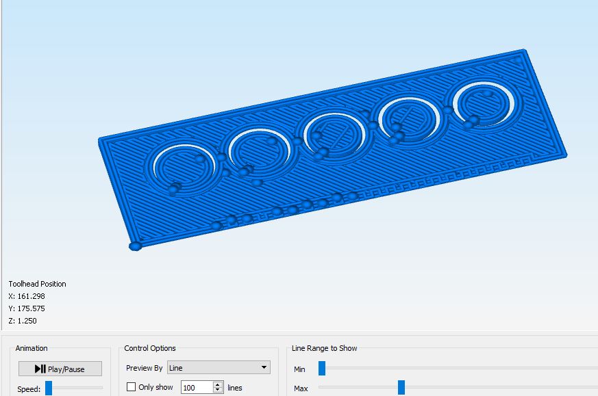

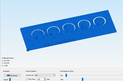

I was printing a peg-hole torture test and noticed my printer was stopping for what seemed like a long time at repeatable points. It turns out S3D was performing extremely slow retracts which made it seem like the printer was paused.
For example, S3D generated a bunch of E-1 F3 slow retracts at the edge retracts in the following picture:
Attached is the stl and the fff.
Hole_Plug_Accuracy_Test.stl
(1.61 MiB) Downloaded 512 times
Hole_Plug_Accuracy_Test.factory
(91.49 KiB) Downloaded 427 times
Here's the gcode where the super slow retracts occur (notice the bunch of E-1.0000 F3):

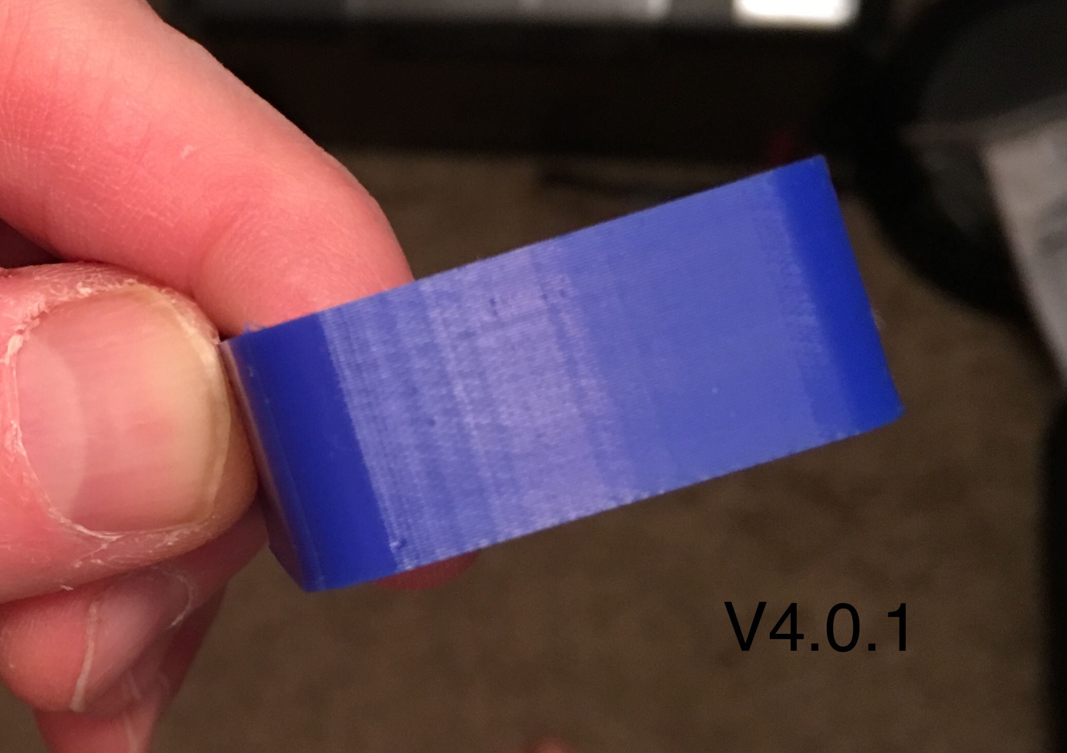

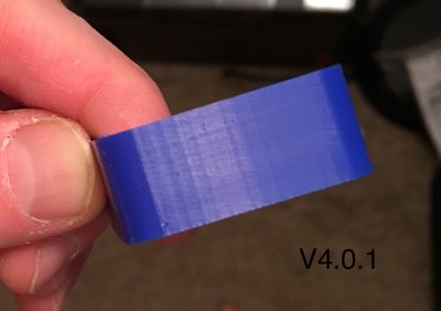

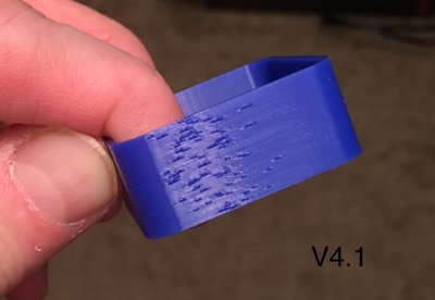

Now I found another major problem with V4.1. The following pic shows how V4.1 is not extruding and/or retracting properly on the perimeters:
V4.1 Perimeter Issues
Here's the same settings in V4.0.1 showing beautiful perimeters on the same part:
V4.0.1 Nice Perimeters On This Part
However as I mentioned at the beginning of this thread, V4.0.1 has major retraction issues and now I found out V4.1 also has a major extrusion and/or retraction issue.
S3D, YOU REALLY NEED TO GET YOUR BETA TESTING UNDER CONTROL. IT'S BEEN A LONG TIME SINCE YOU RELEASED AN UPDATE AND WHEN YOU FINALLY RELEASED ONE IT'S UNUSABLE.
UNFORTUNATELY, I WILL BE FORCED TO USE ANOTHER SLICER UNTIL YOU FIX YOUR MAJOR BUGS AND MAKE V4.1 USABLE.

Re: Major Retraction Bug In S3D
I’m happy to state that both issues mentioned (retract and prime / retract during wipe movement) should be resolved now in the latest 4.1.1 release. Our team successfully tested several factory files from threads mentioning this issue (particularly retract during wipe movement issues in 4.1.0). You should not need to change any settings to have your prints working as expected in the latest version. Retract while wiping and correct retraction/prime values should both be working now in 4.1.1. This was just one of many improvements to the software. All of which are detailed on our Release Notes page.
