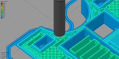

Hello everyone,

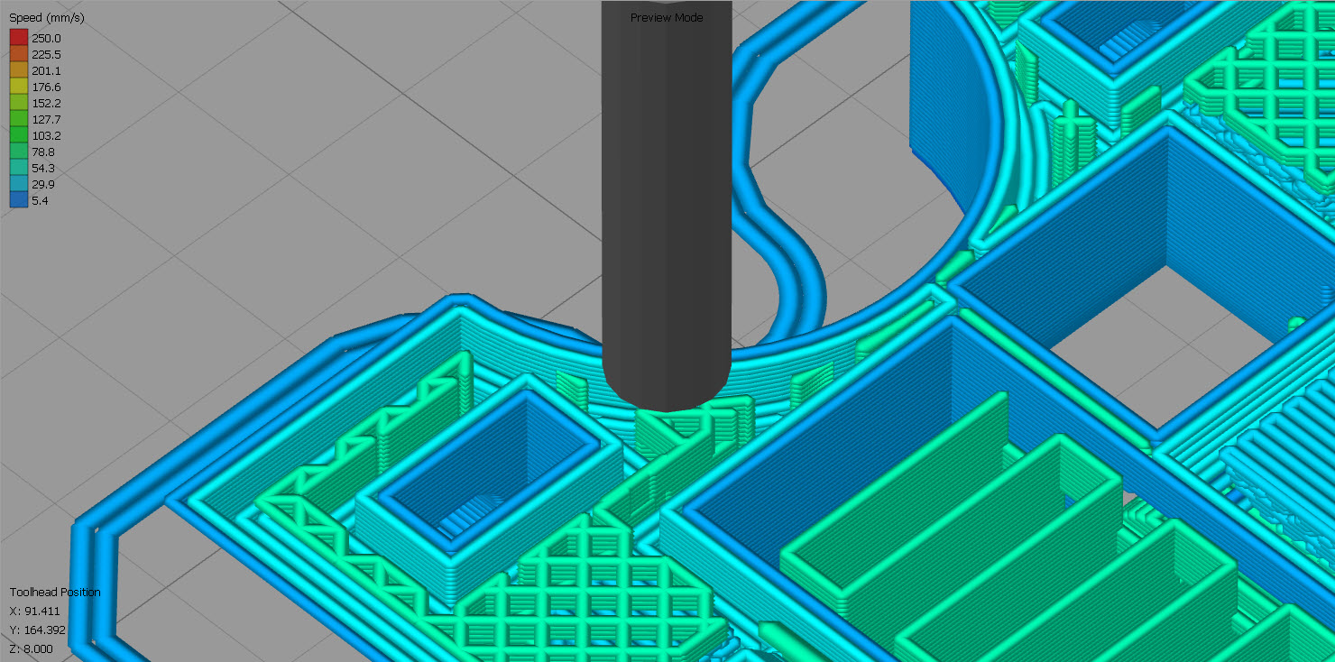

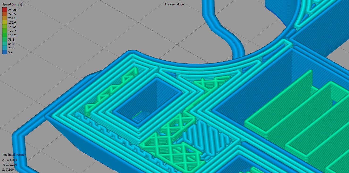

I found an issue with v4.1.0 that is not there on v4.0.0.... Using the same factory file, v4.1.0 is missing perimeters, while v4.0.0 is not. Included are pictures of both v4.1.0 and v4.0.0 at the same height. I also am including the factory file.

I can reproduce this issue to varying degrees by changing the number and % of perimeters and infill.

I am happy to say that this issue with inner perimeters missing has now been fixed in Version 4.1.1. Our team successful tested your factory file in the latest version and the inner perimeters were showing in the preview.
