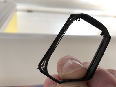

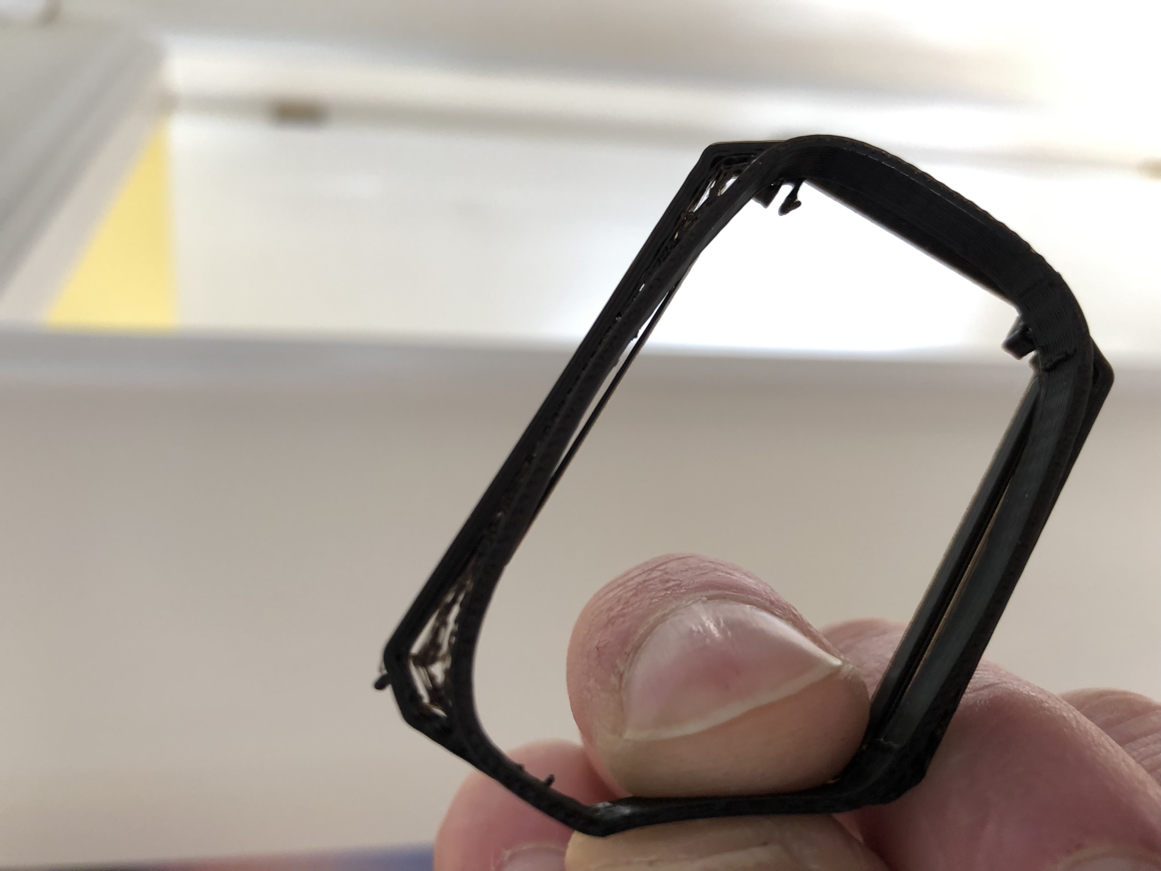

As you can see the infill in the corners is no existent. The process file is the standard wanhao 4s dual within simplyfi3d. Never had issues before, and prints perfect in the MakerBot slicer using standard settings.

Kind of hard to tell but maybe printing too fast for the size? Infill speed too fast? Maybe retraction too aggressive?
Is it an area that needs supports?
A link to the model or upload the factory file would help - File menu > save/export factory file.

I’ve slowed the print down (prints faster in MakerBot with no issues). Infill is default at 100% should I slow it to 30-40%? Supports are used and normally when you remove them it pulls away what is been supporting 🙄. Like I say with other models the printing is fine.

Which version of S3D? The 4.1 version has some issue so maybe it is specific to that? If you have another version maybe try it.

Yeah tried all that. Went back to 4.01. How do I slow the infill speed down, no option in infill tab.
