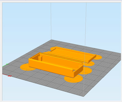

Yesterday I loaded Simplify3D and it informed me that a new version was available and asked if I'd like to install. So I did.
it looks like I was on v3.11 and upgraded to v4.11 but now the 3D graphics when placing the models is messed up.
here is how it looks in 3.11:

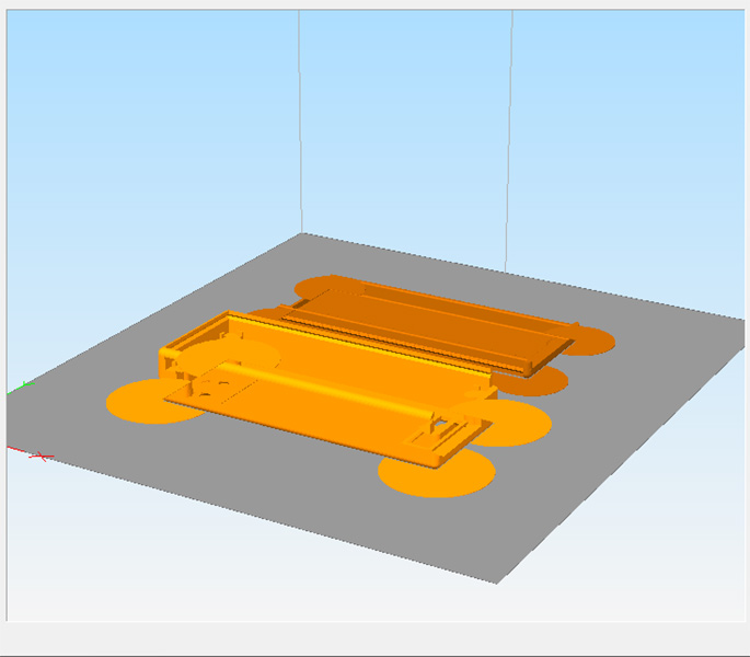

here is how it looks in 4.11:
various walls are missing or displaying in an incorect order and it appears that the grid line texture on the build platform is also missing.

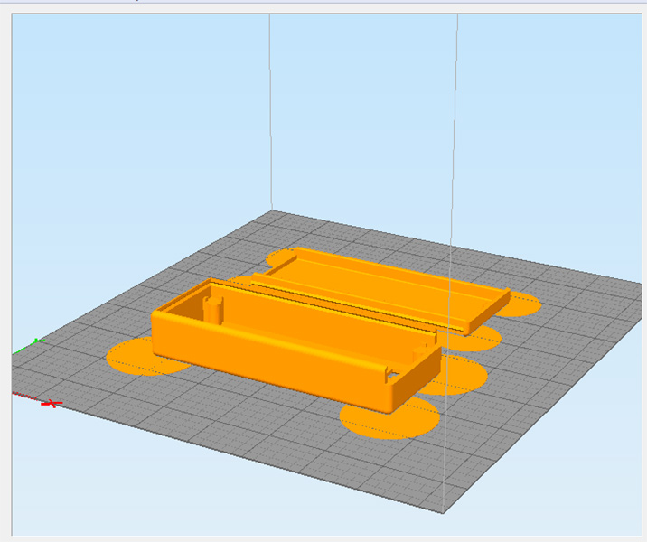

my HP Elitebook2540p is also not the youngest and i am facing simmilar issue.
If you deactivate hardware acceleration then you can see the grid again. Don't know what has changed from prev. version to this in terms of acceleration, but if fixed mine.
But i hope there will be a fix, because no hardware acceleration sounds not nice...
In Options you can define it...give it a try

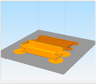

it looks like my "acceleration mode" was set to "automatic"
setting it to "native hardware acceleration" results in a completely black window.
setting it to "compatibility mode" has the same problems as before (this must be what automatic was selecting)
setting it to "disable hardware acceleration" improved it quite a bit but my models are still missing features that flash in and out of visibility depending on the viewing angle.... it's also quite sluggish. :-/
