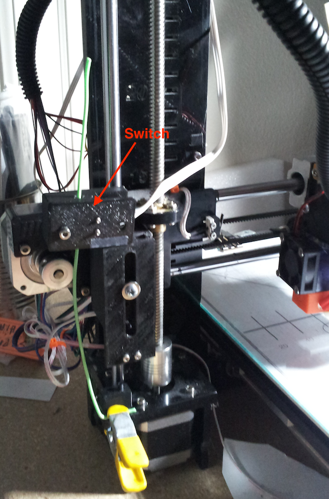

Lastly, a 'Cheater' approach that I sometimes use:
I built my machines and setup the switch to check for broken filament to accommodate this - I don't always use the switch for checking broken filament: The switch is adjustable at any height and there's a short piece of filament, tied to a wire that gets pulled at desired height. That trips the switch and causes a Pause for changing a broken filament and moves the head to front for loading.
It's simply a poorman's approach but, it works.
If you built something like that, you could print a zillion parts and when the switch trips, bingo, you're stopped at the desired height... The ability to do this depends on your machine and your abilities...
FOLLOW-UP My other machine does not have the wire to pull the filament out of the switch (I seldom use that PETg/ABS dedicated machine). But, just to show you the simplicity of doing similar, I just did this - simply mount the switch (with double-sided tape) and fed a section of filament through it. When the switch triggers at the filament's end, Pause happens. So, the only real dialing-in is to determine the height to cut on the green filament in the photo... you get the idea....
