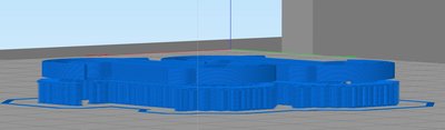

Process 1 can be seen here

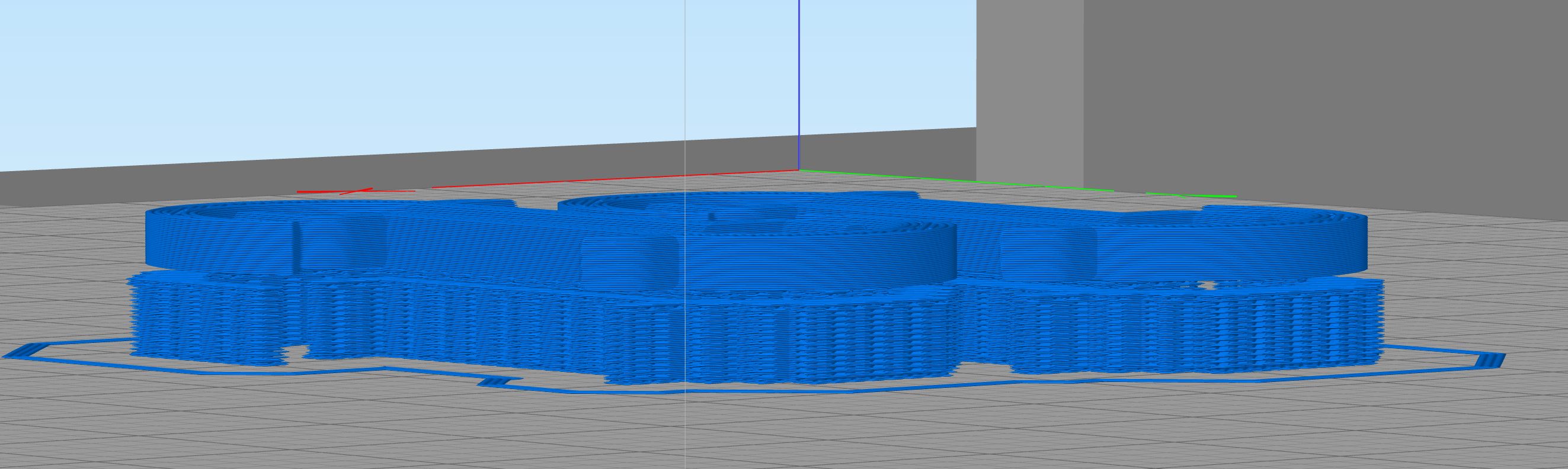

Process 2
And the combined process where both should be generated.

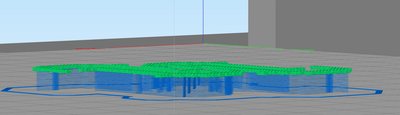

Most recent functional version was 4.0.0
