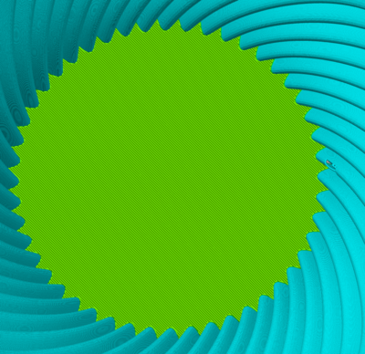

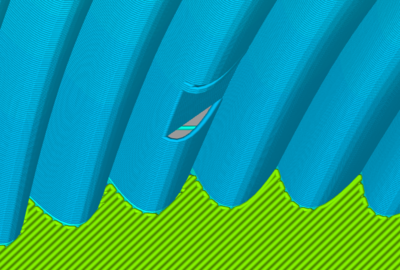

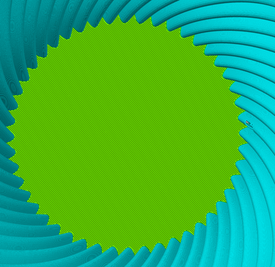

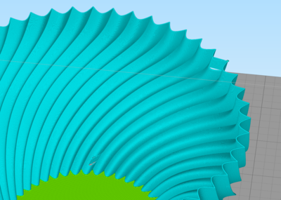

version 4.1.1 slices this model differently when comparing to previous versions: https://www.thingiverse.com/download:3333750
vase mode, layer height 0.15mm, 3 solid bottom layers, no layers at the top
see attachment. why is it so? The model looks fine and many people printed it without issues on other slicers. Confirmed Mac and Windows versions of 4.1.1 does it like this. Looks like a bug to me

how come other slicers don't have a problem with it? even S3D version 4.0.1?
could you say where exactly the problem is in the STL file? I don't see anything wrong with it

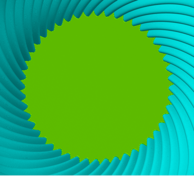

see attached pictures. 4.0.1 does not have this problem

I confirm, there is a "problem" (I don't dare to say "bug") in 4.1.1 for this model.
I've checked the integrity of stl in Netfabb, no bug in it.
This problem is not present in S3D 4.0.1 or CURA 3.3.1
Problem occurs if one of those options is selected for start points : Use random start point OR Optimize start point.
I set manually the start at the middle of the bed (150,150) and problem disapears.
