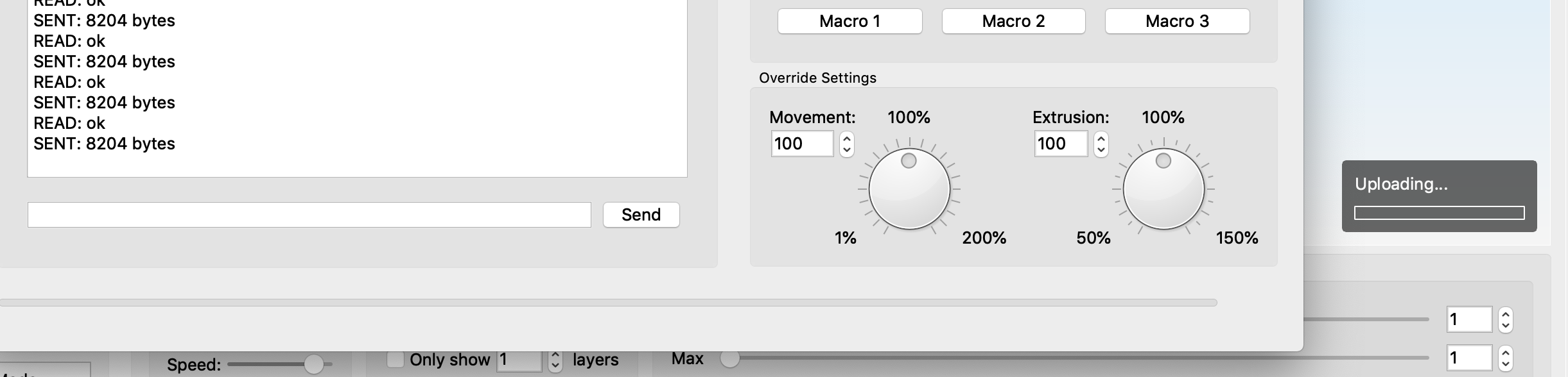

I just upgraded to 4.1.1 and it seems there is no uploading status anymore. Not on the print preview page or the machine control panel. Anyone else seeing this? or actually not seeing this?

No one? Everyone else sees an uploading status?

ok, well I guess this issue just isn't important to the simplify3d folks. It's important to me so I guess I'll be finding another way to print.

Yeah well this printer doesn't have that capability. It has wifi or usb. So without an uploading status you're very much in the dark.

FYI, the way Da Vinci's work is that files are sent via USB to the printer in one shot. Once the file is sent, the computer is out of the loop.
No upload status just means a pause without knowing if all is well. ;) Once the file is sent, S3D returns and the printer starts doing something.
