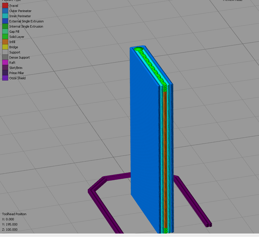

Picture 1 is with 0,44 extrusion width (S3D auto determines 0,48!).
No matter what infill-settings, bottom and top layers are missing. No fill / infill.
Gaps are clearly visible in both the preview as well as in the actual print.

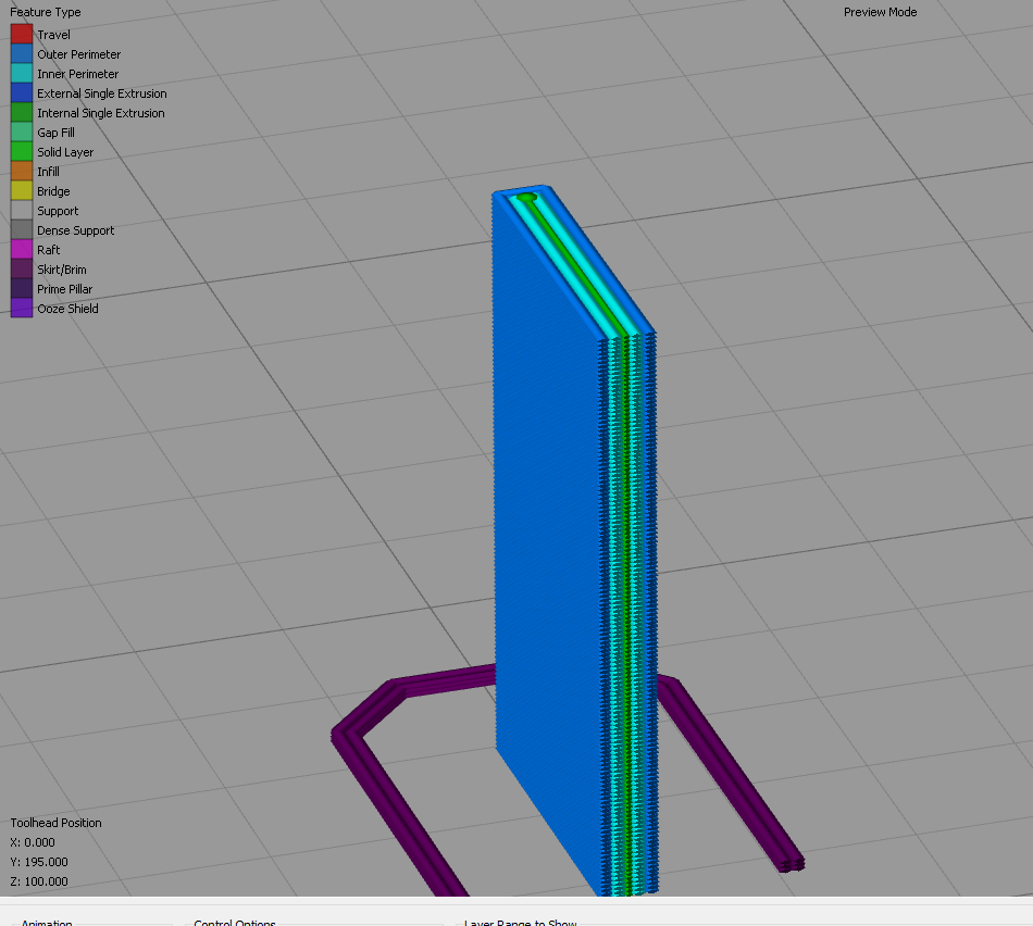

Picture 2 is with 0,4 extrusion width
Top and bottom layers are present but with diagonal top-layer-lines whereas this is the perfect case for single-extrusion fill.
Infill is present as a line.

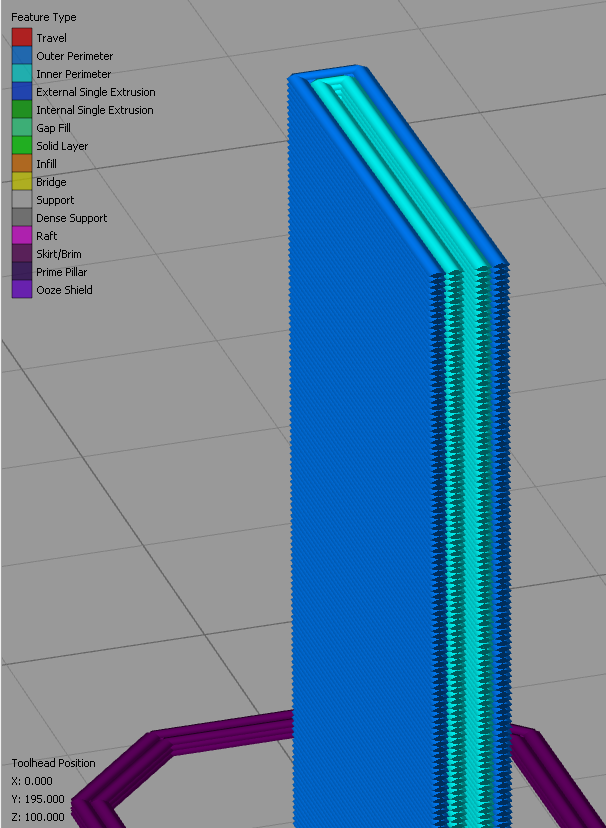

Picture 3 is with 0,44 extrusion width but 3 shells.
Single extrusion fill present but over the complete height.
Can be used as a workaround but not suitable for all models
if you do not want to have 3 shells everywhere. (printing time)

Apologies for taking a couple days blackbird. Thank you for documenting this so well and bringing it up. This is sort of a grey area though as there are multiple different ways to close this gap.
When using a .44mm extrusion width and 2 perimeters you will be left with .28mm of space in the middle of your 2mm wide part. This is too small to be filled with your current infill overlap setting. It would need to be a larger number to allow the software to fill in this section.
If, alternatively, you wanted this filled with Single Extrusion Fill then you would have to use 3 perimeters in this case. Single Extrusion Fill does not replace Infill or Solid Layers but replaces perimeters. With no perimeter to replace there will be no single extrusion.
Re: thin walls not always filled with single extrusions
It looks to me that the "Thin wall" behaviour is not being triggered because the shape is not being identified as being "thin" as the maximum number of shells (in your case, two) can be placed....and what you're getting is the normal infill behaviour.
Upping the number of shells to three invokes the "Thin wall" behaviour as the third shell cannot be placed.
You're bound to now say that this is a bug....but look it logically. What is the difference between a "thin wall" and "not a thin wall"? There has to be something that delineates between the two. In this case, S3D have chosen not reaching the maximum number of shells as the defining factor....which makes sense to me.

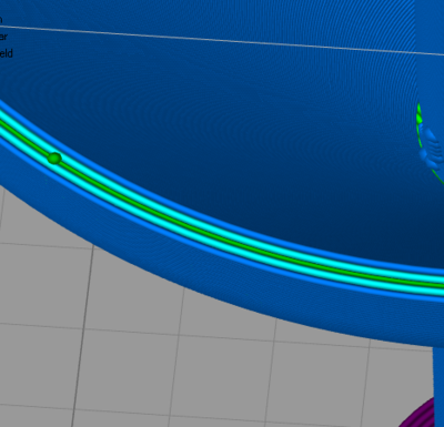

I'm very confused, and I think you can work over the problem. With an outer layer, the dynamic fill is correct, but when there are two layers there is no fill and there are serious gaps. Increasing overlap does not affect print well. The material is a lot and the print is ugly.
Give me advice, what settings should I use to fix the problem?
