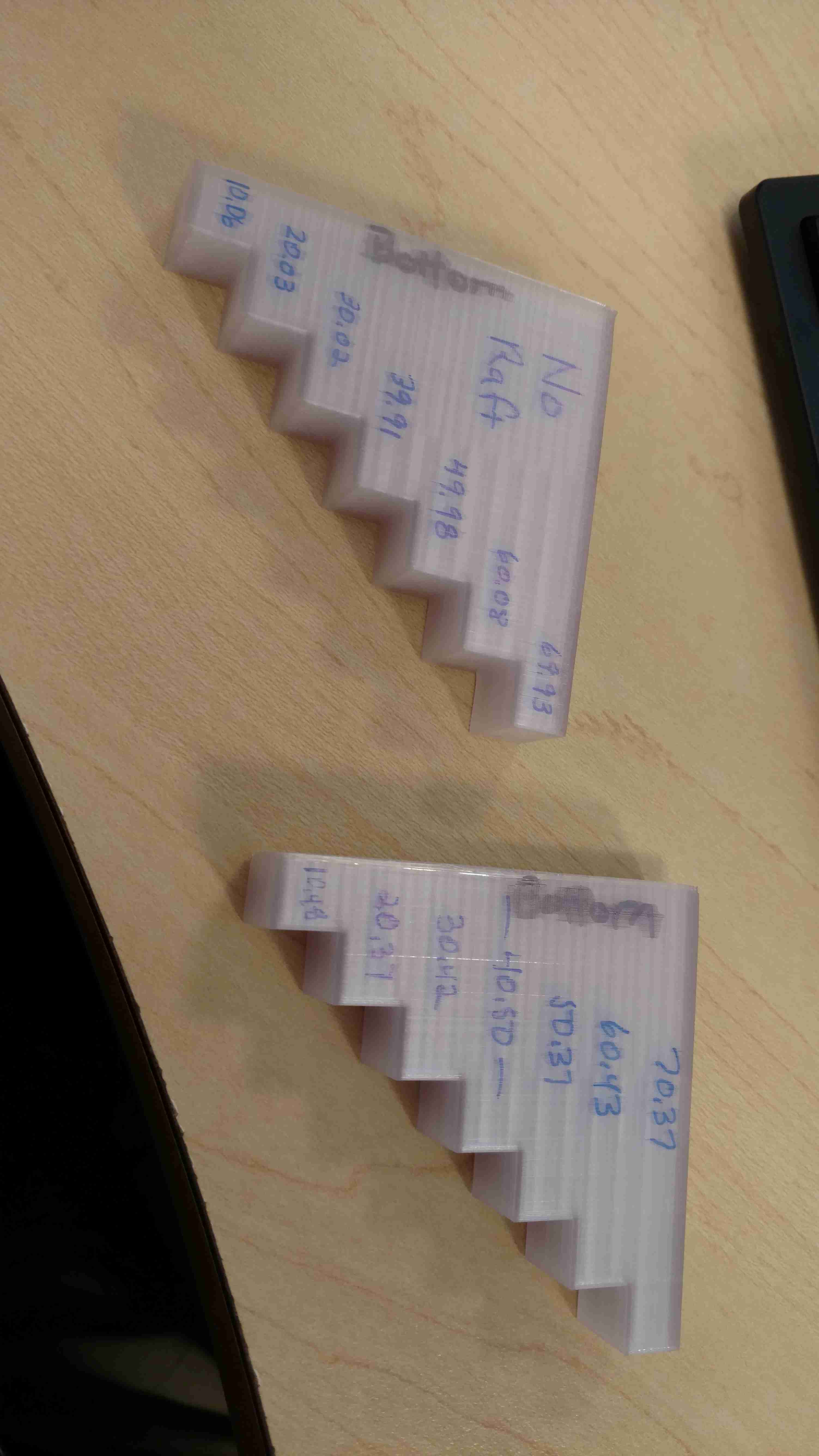

I'll post an fff on monday when I get back to work. Also, I designed a z-axis calibration block, 7 steps with one at every 10mm. I'll be able to measure it Monday morning, will post results then.
My settings at home, that offset is .14mm, at work it's something like .35mm.

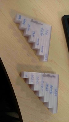

DLrocket89
Posts: 5
Joined: Wed Jan 02, 2019 9:26 pm
Re: Adding raft causes print to be .5mm tall after removing raft
Measured the step block I printed. Every z axis measurement is .4mm long with a raft, spot on without the raft. The Separation Distance in the raft settings is .4mm, so I'm guessing that the issue is coming from that setting.
Is there anything we can do to fix that added height?

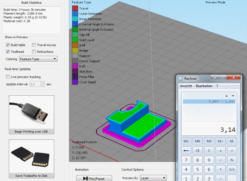

Posts: 861
What ViperZ has written may help for the moment, but it is surely not the solution!
I have tested it with 2 steps on a 10 mm - object at 3 mm and finaly 10 mm.
Layer Height 0,20 mm - without raft
3 mm = 15 layers
10 mm = 50 layers
same with raft
raft = 5 layers, in the print preview Z = 1,917 mm / expected 1 mm (diffence may be caused by the settings of raft)
3 mm = 20 layers (15 + 5) Preview Z = 5,057 mm / difference absolut = 3,14 mm ( cause by +/- 1 layer to print yes or no; parts of layers are not possible)
10 mm = 55 layers (50+5) Preview Z = 12,057 mm / difference absolut = 7,00 mm
Height total 3,14 mm + 7,00 mm = 10,14 mm total of 10,00 mm
desired value.
So I guess, there is an other reason to look for!
>Z = 1,917 mm
>Z = 5,057 mm
>Z = 12,057 mm
What did you ask for these values ​​from?
Posts: 861
Have a look to the pic,
left corner down inside the printtable at the background, has not much contrast.
But can be read out also in the GCode-file, search to the number of the related layer.
H.

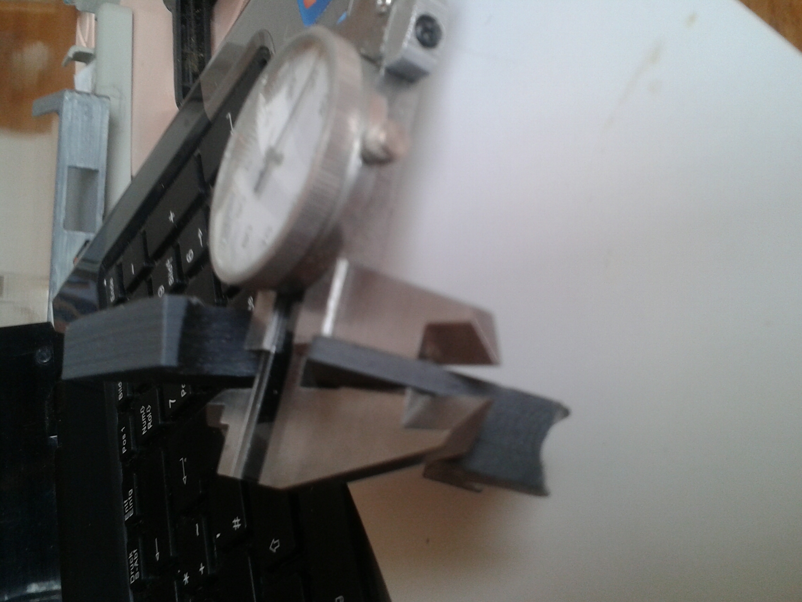

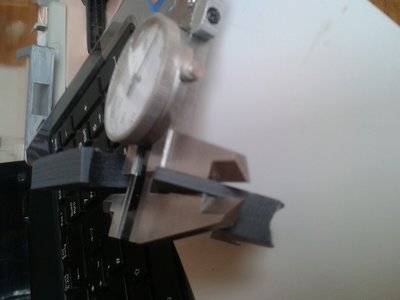

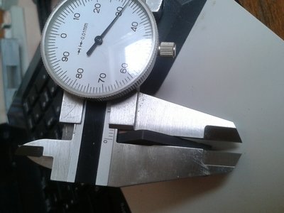

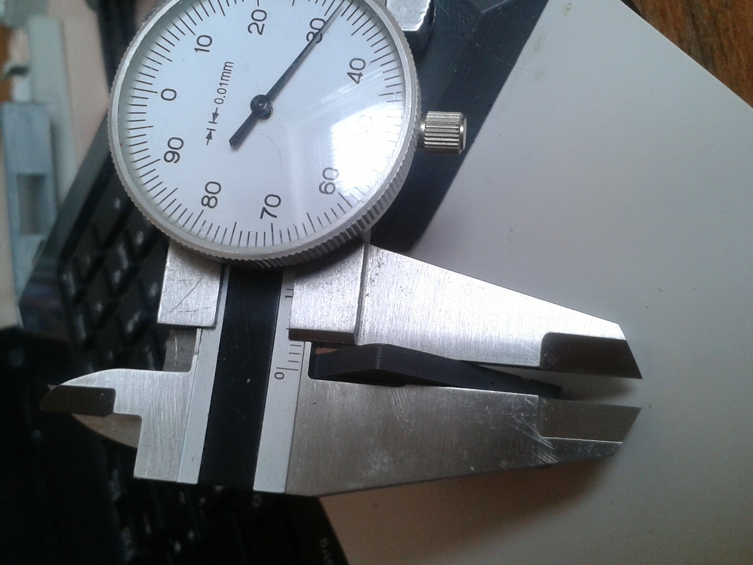

If there are any doubts about the measures , here are the concrete dates measured with a caliper gauge
The printed part - printed without raft - has 3,18 - 3,20 in the middel and on front side 3,30 mm. The height finaly has 10,20 mm May be caused by a light overextrusion I have set to make it stronger. It is a tool to my lathe.
