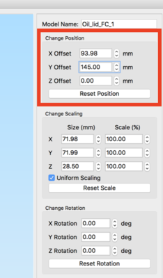

Perhaps the simplest thing to do...
On a Mac: click the model, hold Command key down and drag the model. Other platforms, I don't know keys but, there is one...
Or, simplly double-click the model, a panel opens, change the Position values, click Done.

Ahhh, the control-click (works on a PC as well) is what I was missing!
Thank you! That helps tremendously.
