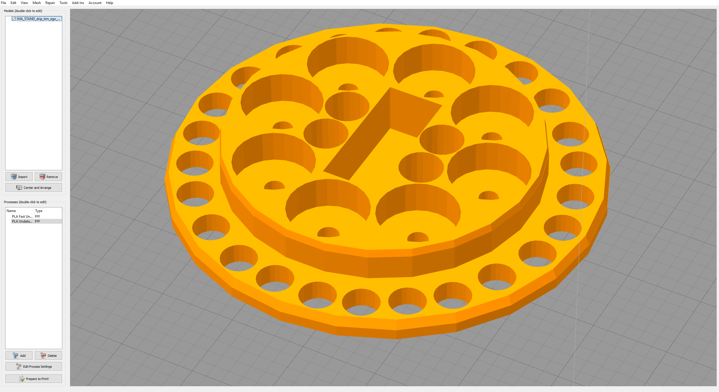

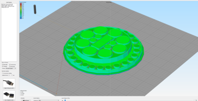

Print getting inverted when sliced??????
Can someone tell me what is going on?
All my prints are doing this when they get sliced all of a sudden.

Have you tried any of the solutions mentioned in our common mesh errors article? https://www.simplify3d.com/support/arti ... sh-errors/

Could it be the “Merge all outlines into a solid model” option under the advanced tab?

Maybe supply a factory file so we can take a look and see if it can be reproduced?
