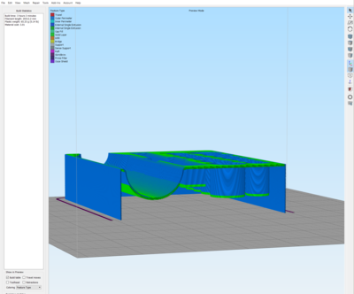

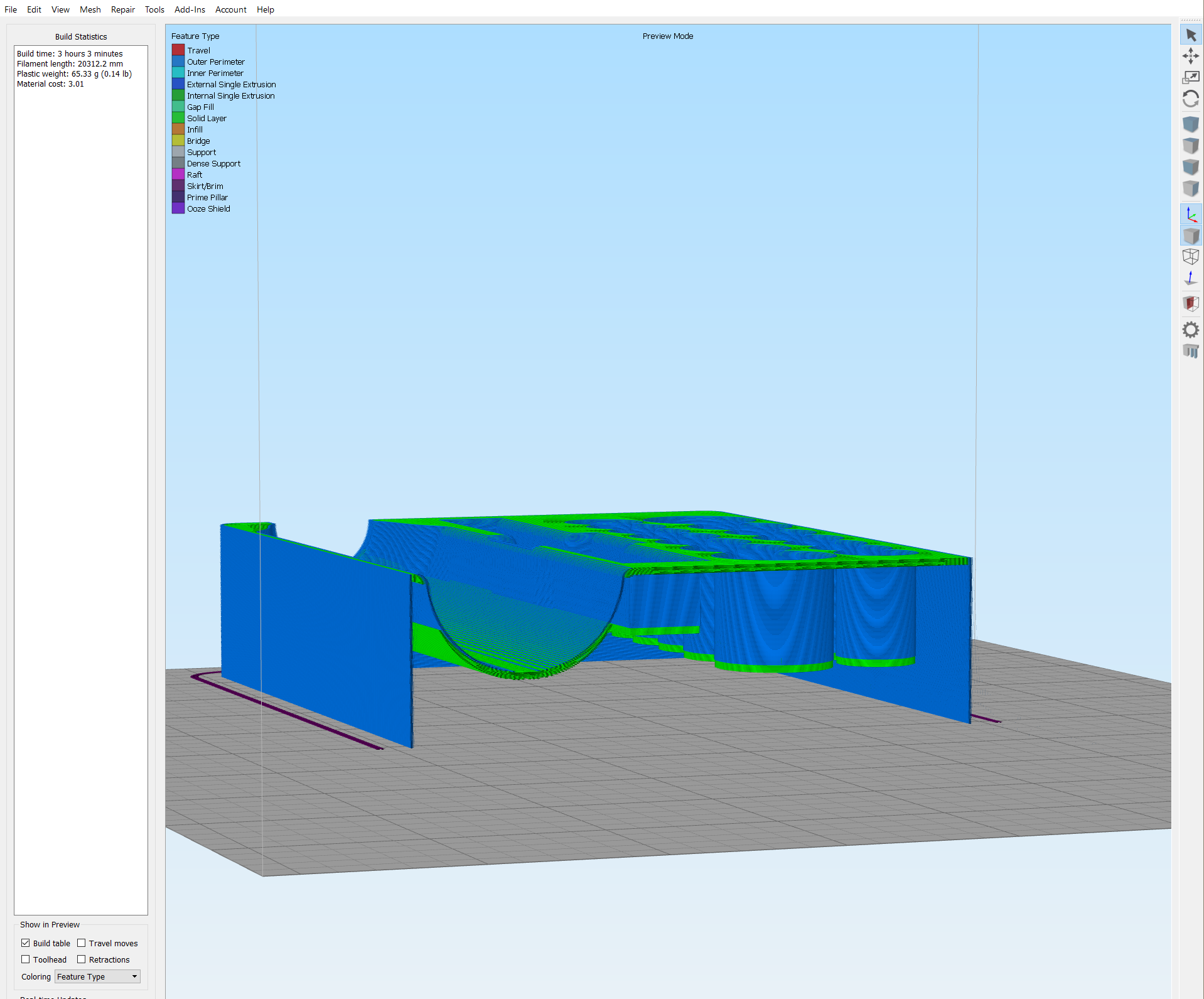

I've been messing with this model for a while and it's driving me nuts. I want 0% infill, 0 bottom layers, but supports for the parts whose bottom layers start off the bed. I have tried every setting i can think of and cannot get the supports to show up in the preview. I've attached my factory file. Any help would be greatly appreciated!

No need to apologize! The Factory File you attached does seem to be a different model though. Just a guess but from the Factory File you sent and the screenshot here I would guess this is probably a mesh error with your model. These can be identified by going to Repair > Identify Non-Manifold edges and Repair > Identify Self-Intersecting Surfaces.
Re: Missing supports
What you are trying to achieve here is impossible to achieve in the way you are trying. You specify zilch INSIDE a model...and then say you want something INSIDE the model! You can't have both!
What you will nee to do is either put some infill to support the top...or redesign the part so that it is hollow on the underside...and then you will be able to place support - to hold the outer surface of the model. There may also be ways to include a second part inside the zero-filled model.....I've never tried this approach, so will refrain from suggesting how it can be achieved.

Doug, I think I understand what you're trying to say. You mean that a hollow part with 0 bottom layers does not equal a "shelled" part. That makes enough sense to me.
As to your suggestions, adding infill with no bottom layer wouldn't work, S3D just won't do it. I suppose redesigning the part so that it's hollow is the proper way to go about it.
