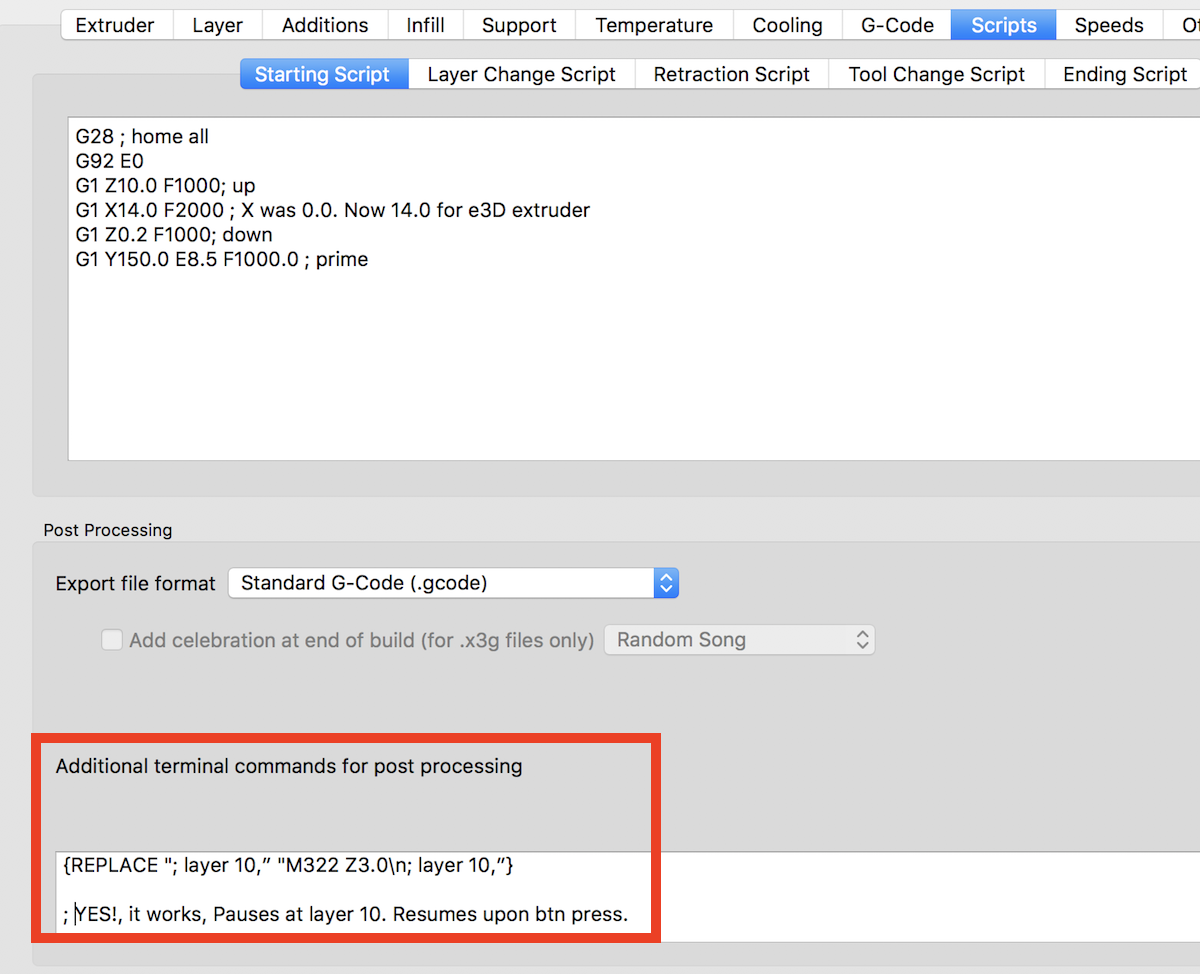

Below is example of what works on my machines.
G & M code commands do not work across the full spectrum of printers - if it works, great. If not, dig into the correct codes for your machine/firmware type.
This code (shown in bold font) goes into the field at the bottom of the Scripts panel (it is independent of the Start, Ending, Layer... scripts)
Example to Pause at specific Layer, at layer=10 and Z=3.0mm
{REPLACE "; layer 10,” "M322 Z3.0\n; layer 10,”}
YES!, it works, Pauses at layer 10. Resumes upon btn press.
