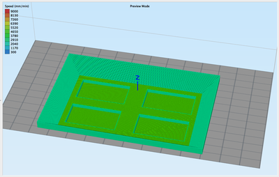

Nice Bonsai drainage pot! It sliced and rendered fine on my laptop too. I processed it with supports and without supports. It took longer to slice with supports (10 seconds vs 45 seconds maybe?) than without supports, but both seem to be fine.
