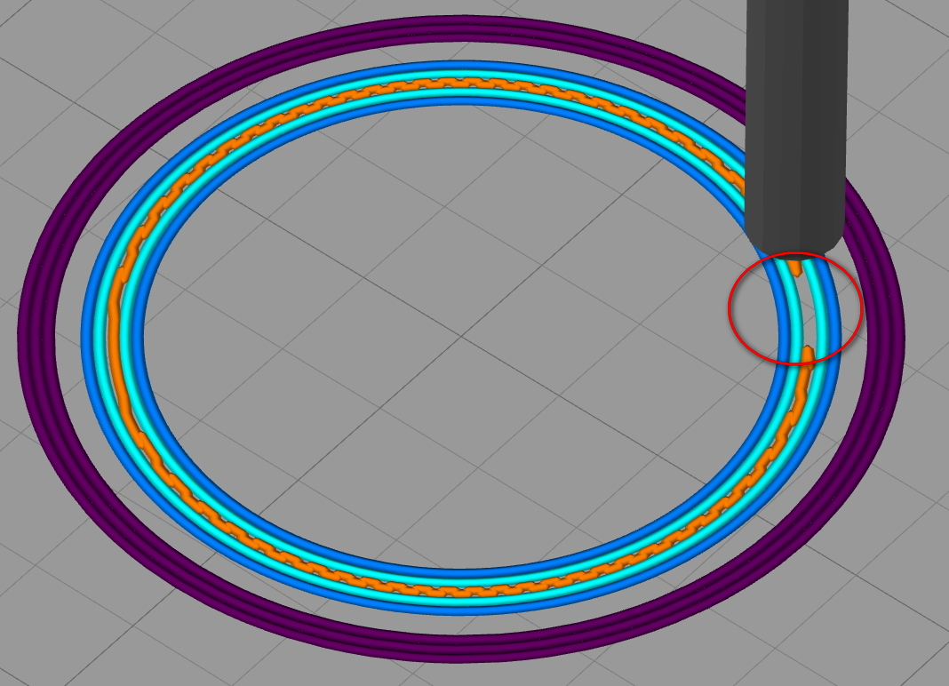

what is the reason for this gap ?
in my case, I print a cylinder and every layer gets this gap
Thank you

Can you please post the factory file for the above cylinder. File Menu>>>>Save Factory File as
Without seeing exactly where your settings are, its almost impossible to give a sensible answer....

dkightley wrote: ↑Tue Sep 03, 2019 8:35 am Can you please post the factory file for the above cylinder. File Menu>>>>Save Factory File as
please
ring.factory
(28.69 KiB) Downloaded 167 times
Re: infill gap
To fine tune the settings to get a good print for this particular shape file, all I needed to do was to change the infill type to "Grid" and the Outline overlap to "11%"
