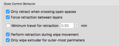

I have attached a photo of my Advanced settings.

Well you need to have wiping turned on as well. Also, you have it set to only wipe on the outer-most outlines, so that's the only place a wipe will happen even if you have it turned on in the Extruder tab

I do have wipe nozzle enabled on the extruder section.
I only want to wipe the external perimeter, so hence why this setting is enabled.
The machine does the wipe movement, just doesn't retract during this?

how about turning off the only retract when crossing outlines. I believe this will negate retraction any other time.

I did turn this on, but still doesn't fix it.
The only way I have managed to get this to work is to set a minimum retract distance (0.5mm) and disable "Only retract when crossing open spaces".
This causes havoc and there are so many retracts on complex parts!
I am not sure if this is how it's meant to work?
Would be good to hear if anyone else has managed to get this to work and what their settings are?
I think the "Only retract when crossing open spaces" is the key setting here.

I have the exact same problem.
There is no retraction on wipe nozzle like it's supposed to.
To be retraction on wipe nozzle like it's supposed to "only retract when crossing open spaces" must be unchecked.
