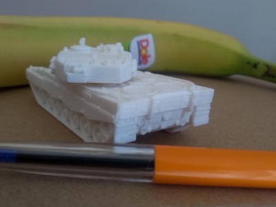

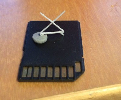

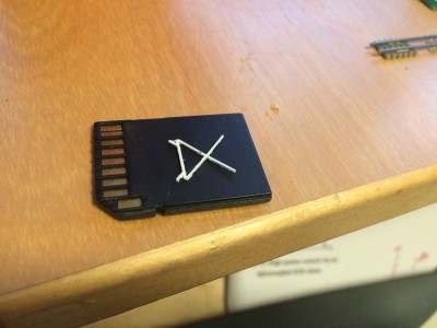

I've been successful in printing this part, which is the smallest of six internal structure parts for a girder bridge for a T gauge model railway layout:
The part is 10 x 12 x 0.6mm, and the thinnest part is 0.4 x 0.6mm. Printed in PLA with a 0.2mm nozzle at 0.06mm layer thickness on a MakerBot Replicator 2. And, yes, that's a SD card the part is on!

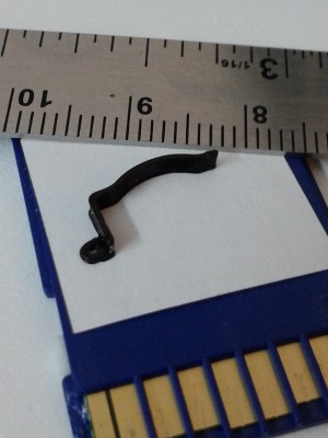

- this crossbrace you printed, I printed something similar, these days, this type of stuff, I usually do with 3d pen and not with printer
- I remember your miniature automobil from the first question - I never printed something like that but I did print on UP Plus2 the miniature pump that has even smaller parts than that automobil ... it was a complete water/air pump in 10x10x10mm with moving parts, fins etc.. but for e.g. that part I was only ever able to print in teartime ABS (it is printed at 266-270C) and never with any "normal" material.. that ABS they sell also allow for the super easy removal of supports and other stuff teartime/up3d printers were known for.. never figured out what's the deal but I assume the ABS modified to be extruded at such high temperatures probbly solidifies quickly (plastic will drop 10-20C much faster from 270C than from 240C) so that might have to do with these small parts and how their old slicer handled them... now neither that pump nor old slicer (that was good, the new one is awfull so lot of users replaced closed source electronics and moved to something open so they can use other slicers)

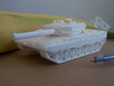

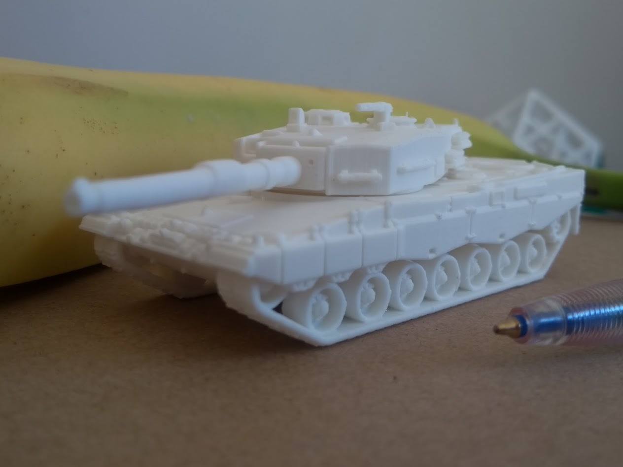

Leopard 1:100 scale tank. Printed on UP300.
0.20mm nozzle
0.10mm layers.
Esun ABS white
Hotend: 245c
Heatbed: 110c
Speed: defaults settings for "Fine" mode (around 20-30mm/s)
https://www.facebook.com/photo.php?fbid ... pe=1&ifg=1
you can for sure contact the guy on FB for more details

i'm on a 1/10 rc truck project and i design all the part of the body, in some case i feel like it's big on the PC screen but on the printer's bed it's so small that i wonder if this is going to print well hehehehe
the part is 14mm long x 4mm wide x 2mm high
i print this with a 0.4 nozzle, 0.1 layers and 0.5mm wall on the xmachines lorei that crash on kickstarter
i have some other parts smaller to print
