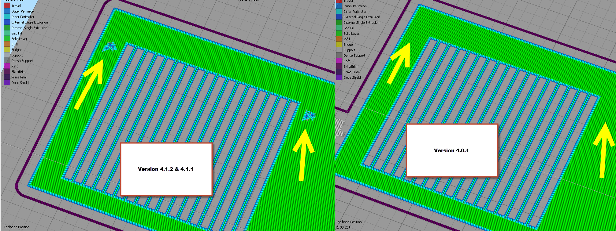

Not sure what to call it other than certain versions of S3D are creating problem areas in the model when sliced.
See pictures.
This is layer 1 of a simple box. Two versions create the spots at the arrows while one other version slices correctly.
Versions are indicated in the pictures.
This model was made in Fusion 360 and also run through Netfabb and has no errors.
S3D is creating these spots where nothing but a solid layer should be.
Thanks for any ideas on this.

It is only a problem in the two recent versions. The older versions of 4 do ok.
Also this isn't the only file that does this. I have others that do similar things.

the issue may be existing in the older version or it is more tolerant against this construction failure .

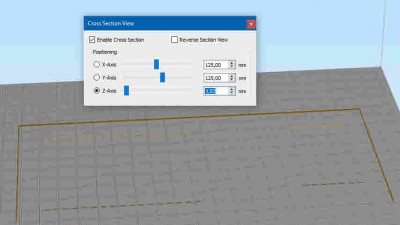

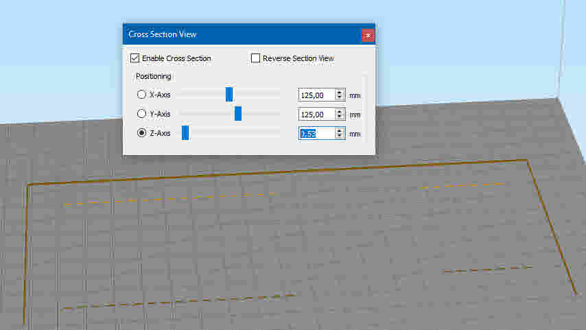

What you see is the foundation of your screw towers and the boring is not going through the first layer.
Your model is laying on level -1.00 mm and starts to print the first layer on 0.53 mm while the skirt / brim is printed correctly starting on zero.
How do you have created the screw towers? I guess this is one of the reasons for this occurrence.
