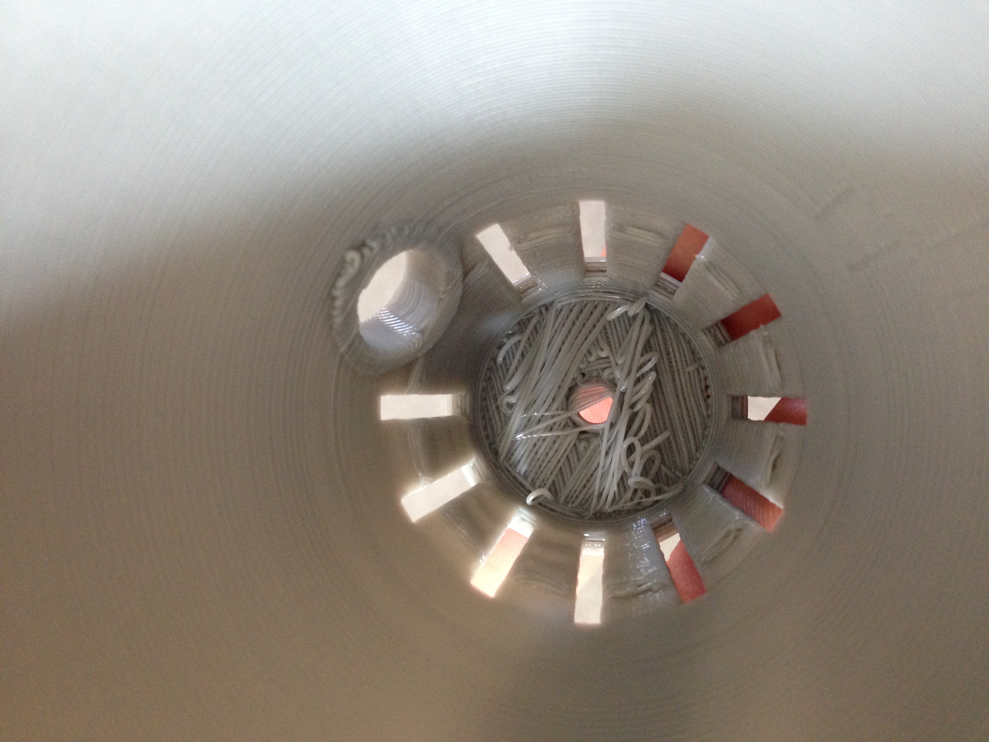

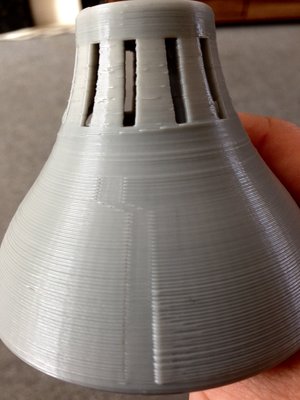

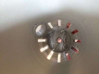

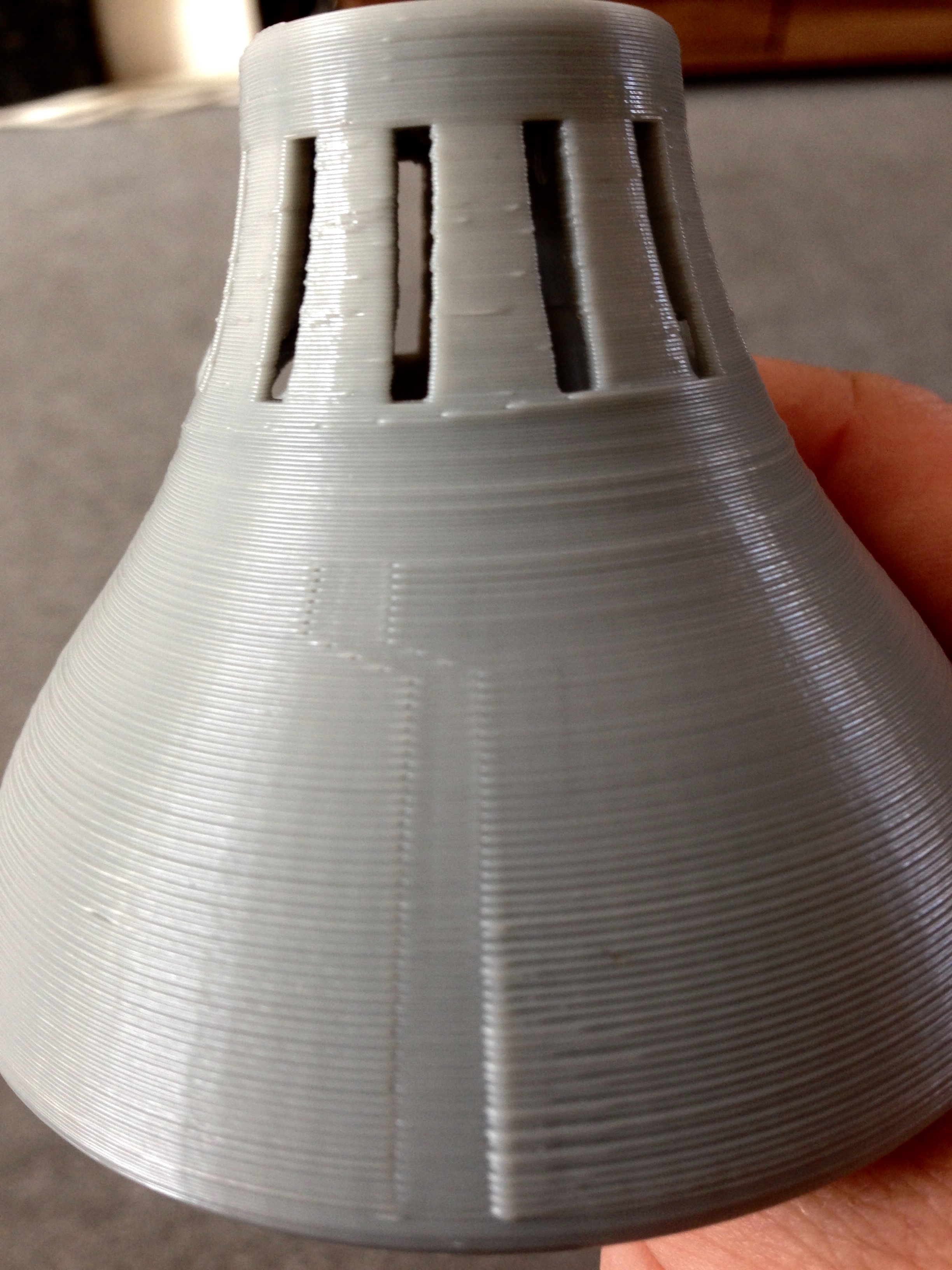

I've tried to print something today though and as you can see in the pictures, it's not the best print in the world, any thoughts on whats causing this? The bridging is not great and the start/end point is terrible, it seems to improve to further up the model. When I print other objects they seem to come out ok with the current settings.
Attached is my factory file and 2 images.
Thanks again for the help.

Any bridge with a hole in it is going to have problems. Firstly the perimeters of the hole will be printed in mid-air, and secondly there is no way to bridge across the hole so the bridging infill has to stop in mid-air. The usual way to overcome the problem is by making the first bridge layer solid (no hole) so as to create a membrane that the hole can be printed onto in subsequent layers. After printing, the 1-layer membrane is drilled or pushed out. That requires a modification to the design or STL - easy if it is your own design, but will require a way to edit the STL if it is a Thingiverse item.
As for the blobbing problem - if KissSlicer does not have that problem I suggest you look for every difference in the settings you have between that application and S3D. One thing I can think of is that maybe KissSlicer is printing outer perimeters first, while S3D is printing them last. You can easily change that in S3D. Having outer perimeters printed first can move the blobs from the outside to the inner perimeter where it is not noticeable.

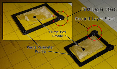

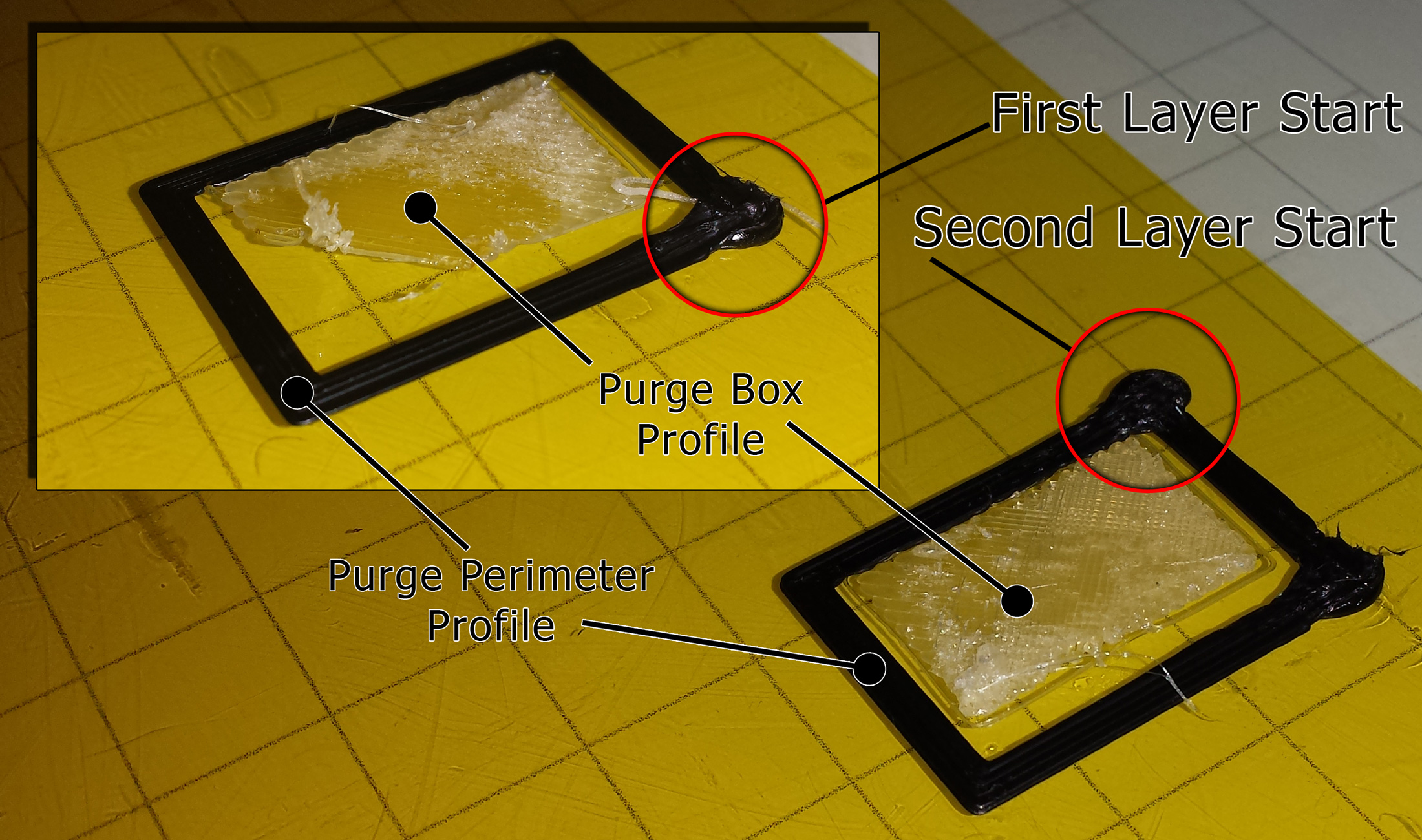

I am having a similar issue. Are you running multiple processes on multiple parts when you print this? Can you see the extruder stepper motor running while the head is not moving at the start of each layer (where it makes the blob)? I have a ticket open with SD3 support so I will see what they come back with. I will post again if I can get the issue fixed. Here is what I am dealing with:
No matter what I do, the ooze control from the first process in the list is overwriting the ooze control for other subsequent processes. So for this instance, I am applying the "Purge Box" fff to the inner box that is to be PVA. So I need a lot of retraction to control the ooze as well as a lot of restart distance to get it back extruding again. I create this profile and select the model(s) I want to apply it to. Great. Here are the problems that creates:
Problem 1: The ooze control settings for "Purge Box" are being applied to "Purge Perimeter" where I just want a simple ABS extrusion on the right nozzle with just 1.75mm of retraction and no extra restart distance. So I am getting a full 10mm of extra restart distance no matter what I select for that process. It overwrites and applies to all models, I have tried to add more models and more processes to the build and it is the same thing.
Problem 2: The extra restart distance on the left nozzle is reversed. It retracts instead of extrudes. I have tried negative values in the box and it still does the same thing. So I can only retract with the left nozzle. With 10mm of retraction applied twice, the filament is completely pulled out of the nozzle.
Problem 3: If explicitly tell SD3 that I want the infill with the left nozzle. When I apply this process to the inner box, it just goes ahead and fills it with the right nozzle. It doesn't matter what I change, it will only fill using one nozzle or the other in a single process. You have to use a single nozzle for an entire part and cannot get SD3 to apply fills with the other nozzle.
I have tried all the obvious things like recreating profiles, reloading firmware, etc. It just seems that SD3 has no support for multi-nozzle machines. It also doesn't seem to correctly apply separate processes to different models on a single build. I am building this stupid box in the picture because I will have to put it next to each part so that the second nozzle stays flowing on larger parts. By the time the machine builds a raft, the second nozzle is frozen up and needs a serious purge before it gets flowing again. Then it oozes everywhere. And I obviously can't control the ooze. So the "purge box" is going to be built along side my part to keep things flowing the left extruder. So this is really a problem created by another problem. Hopefully it will get fixed... I really like the lines that SD3 creates with it slicing algorithm and want to use it. I just can't in it's current state given these bugs.
