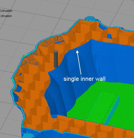

This is something Cura has implemented and it's a fantastic option. You have the ability to assign specific profiles / or profile properties to a separate mesh so it can influence specific operations in the slicer. My biggest issue was wanting to add a hollow space inside infill on large parts.
Pics from other thread added here -
S3D test mock up
Cura slice using boolean insert mesh to create inner space with 0% infill
End goal is to have a slow printing outer wall, three fast printing inner walls, a 1" deep layer of infill with a single fast printing inner cavity wall, 1 bottom and 1 top layer for the inner cavity wall.
The main outer shell object has a profile with 10% infill, one slow outer wall, three fast inner walls and 6 top and bottom layers.
The insert mesh (inner cavity object) has a 0% infill setting with a single fast printing wall, 1 top and 1 bottom layer.
Hope this all makes sense !
