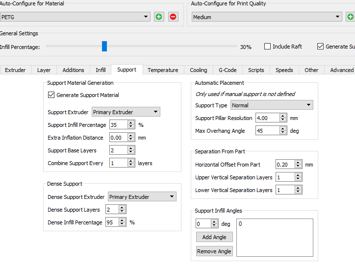

I have finally dialed in most of the settings for PETG on my machine. Nice prints no stringing. However, I cannot get the support to stick to previously just printed surface. I have tried with and without using the part cooling fan. The supports start 8 hours into the print so this is getting expensive and frustrating. I am using a .4mm nozzle, hot-end 240 degrees, and 85-degree bed temp.

Just FYI, I've had pretty good luck with PETG supports. Some geometries work better than others, of course. I created a virtual extruder, so I could have really different parameters if needed.
With a 0.4 nozzle, I typically run EW at 0.50, including supports, but I have run them down to 0.40. I also drop the EM down to 0.70 (I don't recall if I've tried lower or not). Choose the virtual extruder on the support tab. I run 30% infill, inflation only rarely, support base layer of 1 if the support's contact area is pretty small, and combine every layer. Under Dense Support, again choose the virtual extruder, and 2 dense support layers at 70% infill.
Horizontal offset is 0.70, with a single separation layer for upper & lower. Angles are usually 45 & -45, but those will change depending on geometry.

Thank you for the advice. I set up a virtual extruder as you suggested. I then printed the support test 3mm from Thingiverse so as not to waste time and material. The print was perfect, smooth, with sharp corners. The supports, however, were a total no go. they just did not stick to the previously printed. layers.

That is what I said! The issue I believe comes from the (Separation from Part) "Upper vertical Separation Layers" under the Support Tab, my value is 1. I assume this to mean 1 layer is skipped to minimize adhesion thus allowing separation of supports later. This separation is enough regardless of the sticking potential of PETG to facilitate spontaneous layer separation (model to support) in my case the part is 300mm by 200mm. Where the bed is much smaller MP Mini I used the same settings to print successfully 6 rolls of PETG and that is with part cooling. On a large part, all bets are off probably because the surface temperature of the part is significantly lower than the original bed temp and the hot end to surface distance is greater x2 the ideal print height. The result is no stick instead of the desired "weaker stick." I have not been able to figure out how to overcome this in the Simplify3D support settings. That is why I have posted my question here.
TN Yankee presented the best workaround using the virtual hot end. I just cannot seem to sneak up on the right setting combinations that work with this very large piece. I have printed the Support Test part from Thingiverse successfully on the larger machine, however, the larger print is still a no go.
the next obvious change would be to increase the extruded material temperature for the first support layer using the virtual extruder. But I have questions. If I add a virtual extruder in the Temperature tab I must also add a Temperature Identifier which I assume will not be recognized by my Rip Rap config.g secondly how do I specify the layer for this temp change to start and stop?
