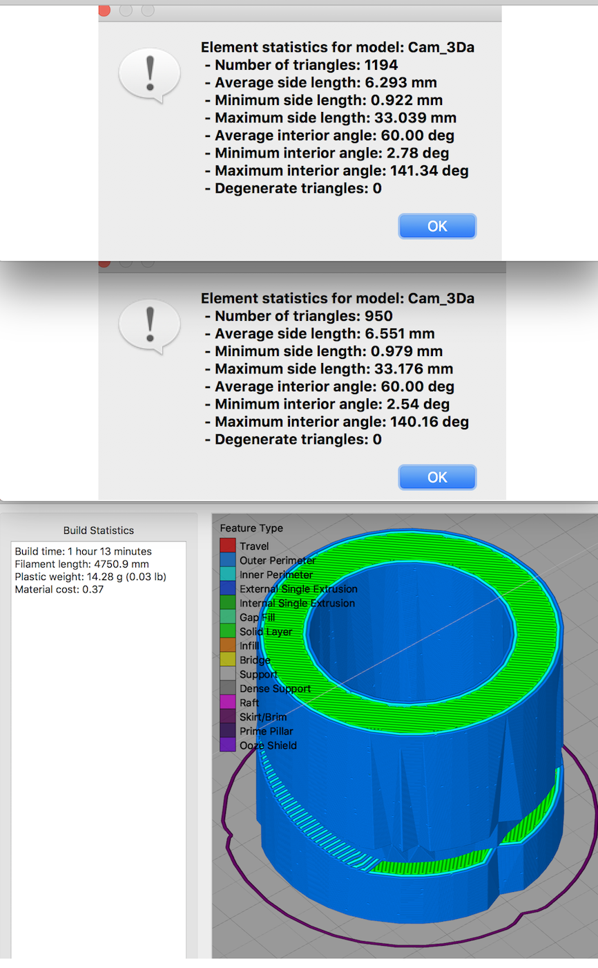

I've gone through this exercise so many times to produce parts for 3D-printing and CNC milling...
Here's the upshot (IMO)
I make my own models (generally using FreeCAD or SolidWorks). The CAD software is where the Resolution is dealt with (though some slicers have limited capability, too. Including S3D !!)
But, frankly there is Minimal benefit to reducing the resolution. Print-time is not reduced very much (though, I suppose on a print that takes 24 hours, you may save 20 minutes).
Example 1:
Comparison of a Model with two different resolutions and the S3D Pre-Print output.
Resolution was set in CAD with a difference of 'One Magnitude' (i.e., 0.2% and 0.02% Tesselation's).
Note the difference in File Size and that only One Minute was saved on a 1 hr print.
Example 2:
Resolution reduced in S3D using the feature "Mesh Reduction" Look at your Meubar/pull-down's (also the Mesh info shown).
Though the Model's mesh count was reduced (resulting in destroying the shape - obvious deformations) the, pre-print shows no benefit in Time or Filament used....

if you try to export a single layer (ex 0.2 mm) cylinder in different STL resolution you will observe that S3D will not mantain a linear relationship between the number of triangles of the cylinder surface and the number of G1 instructions. Slicing a perfect cube is also an illuminating example.
Sadly we don't know the S3D's algorithms and how the software internally answer the question: "Was this tessellated surface a curved surface or an intentionally tessellated shape?" So we have nothing but closing our eyes and press the "slice" button.
