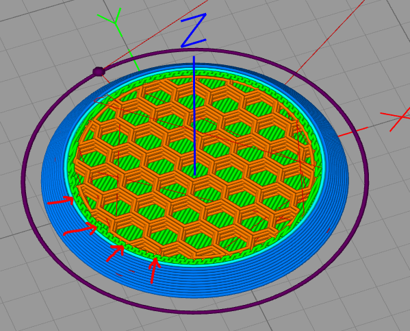

2. The ability to install concentric continuous filling only for the upper or lower layer. Reduced print speed for the top layer only. At the moment, it is solved by two processes, which is inconvenient. Shown in picture 1 and 1b.
3. Variable extrusion with concentric continuous filling. Needed for an integer number of lines. A fixed extrusion width causes a gap defect, shown in Figure 2.
4. Decrease in print speed with concentric continuous filling as it approaches the center. Constant speed causes a defect closer to the center of the part. You have to reduce the overall print speed or create two processes. Shown in Figure 1b.
