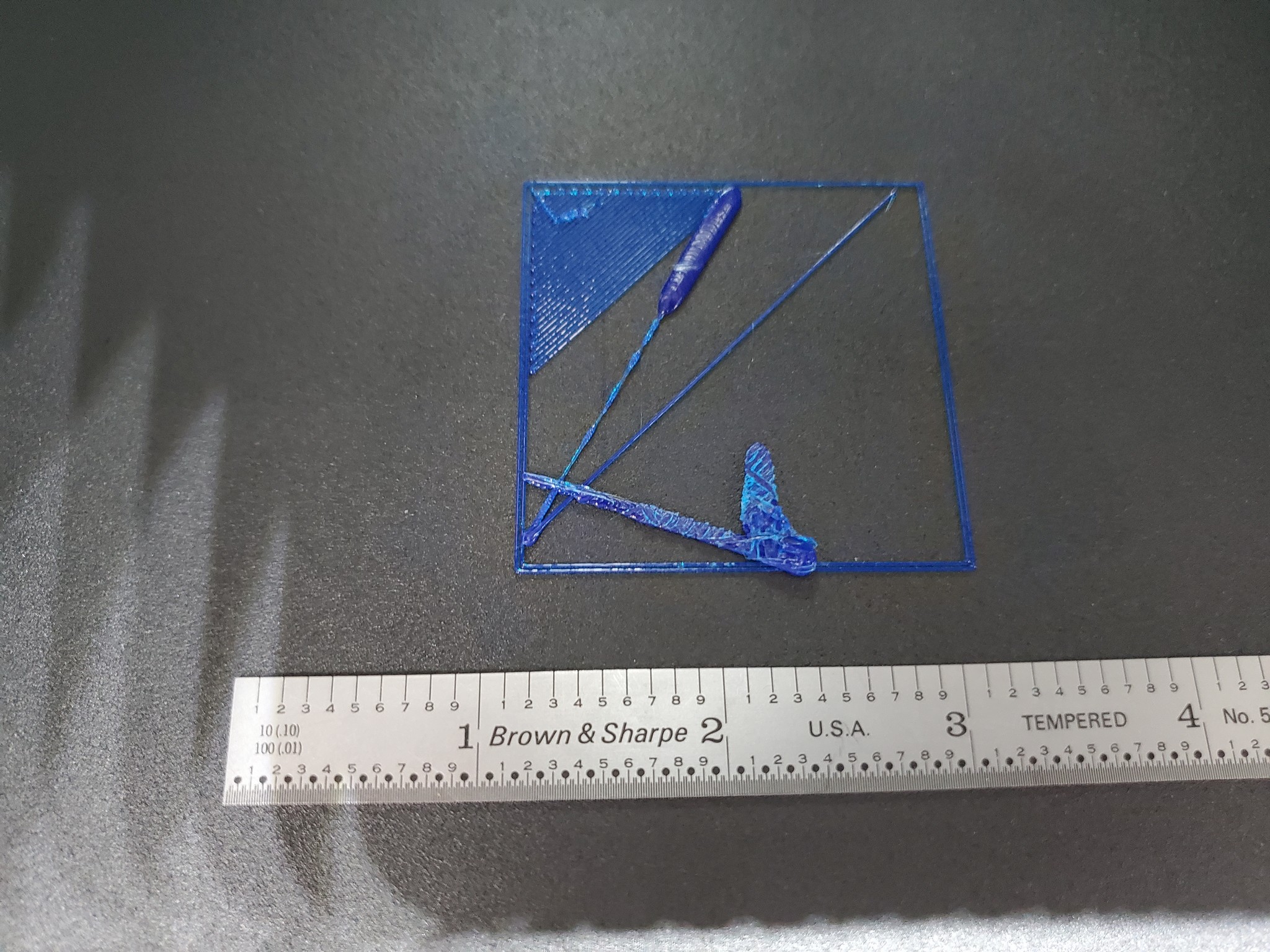

I recently purchased a Creator 3 Pro and upgraded to Simplify3D V5. I can send a job to the printer but it prints very erratically and doesn't resemble the part at all. I have a PowerSpec Ultra and the same file prints correctly. I've sent numerous files to Simplify and they communicated at first, but now I can't get them to respond. Very disappointing. They've always been responsive in the past.
Re: Flashforge Creator 3 and Simplify 3D New User?
This thread is pretty old, so I might suggest making a new one specifically about V5. I know we've been able to print fine on our Creator 3 using the new V5 profiles, so it's possible it may also be a problem with the specific settings or files you are using. Including an example .gx file could help for example.

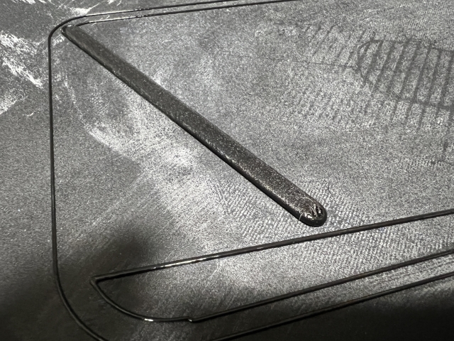

I have a creator 3 pro and had the same issue when sending over by wifi.
Each time it takes ages to transfer the file and then prints rubbish, but never the same rubbish even when sending the same file.
If I put file on an SD card for transfer it works ok.
I got a very similar looking line where it went very slow and pumped out extrusion in a wide line.
If you are having trouble using the new wifi printing in V5, please start a new thread so we can discuss that more. This thread is quite old and was just about adding support for the Creator 3 into Simplify3D. As of version 5.0.0, the Creator 3 is now fully supported, including wifi and ethernet printing along with duplication and mirror mode. Just go to Help > Configuration Assistant, search for the "Creator 3", and you can download all the relevant settings.
